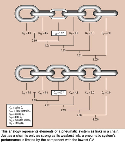

Finding the weak link
To gain further insight, compare a component's conductance to the strength of a single link of a chain and the system conductance to the strength of the entire strand of chain. This is not an exact analogy, but is convenient and easy to relate to. The chain's strength is dictated by its weakest link, which must support the maximum load applied to it. So, too, the component with lowest Cv dictates the system's Cvs . This system Cvs is always less than the lowest component Cv . This is evident from the example with three devices, whose Cvs were 1, 2, and 3. When we they were combined, the result was 0.857. If only 1 and 2 were combined, the result would have been 0.894. The equation that reflects this phenomenon is the addition of reciprocals and applies to electricity as well.
This phenomenon means that no single component in a circuit is more significant than its neighbor. As in a chain, each link is as important as the next, and each must carry its load; if not, the entire network collapses. To increase capacity of a chain, we must replace or strengthen the weakest link. As a corollary to this, to improve the speed of a cylinder, we must eliminate the lowest Cv in the circuit by replacing or modifying the limiting component.
To understand another example, refer to the figure at the bottom of the page, which illustrates the analogy by representing Cv s of components in a pneumatic system as links in a chain. If a cylinder's piston moves too slowly, a larger valve often is specified in an attempt to rectify the problem. However, if the goal is to cut the cylinder's extend time in half, it should be apparent that increasing the valve Cv (size) renders only a negligible improvement to the overall system Cvs . The reason should be obvious — namely, the valve is not the weakest link. In order to improve the performance of the system, the weak link must be replaced — which means replacing or modifying the component with the lowest Cv .
In this example, the offending link turns out to be a restrictive orifice; supplanting it with a larger orifice will achieve the desired cycle time. No volume changes took place in any of the components; the only modification to reduce cycle time was to increase Cvs . The lesson here is that we should always calculate and display the Cv of every component of a circuit in a survey. We then can quickly identify the lowest Cv and take action to increase it.
