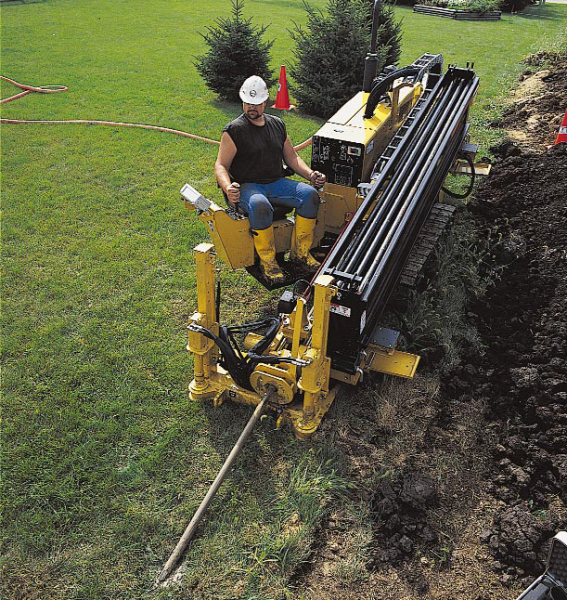

Directional boring has revolutionized installation of underground cable and piping -- and this modern technology would not be what it is without hydraulics.
Figure 1. Directional boring machine uses hydraulics to push and direct underground drill to target hundreds of feet away, even if a freeway, river, or other major obstacle is situated between the machine and the target.

Early directional boring machines had to be towed to a location and set up. Newer machines, however, are self-propelled and self contained. In a typical machine, a hydraulic system provides power for a pair of track drive motors, a stakedown system, and all boring functions. Once at the work site, an operator need only connect the machine to a source of water. So, in a way, these machines combine new techniques with old — you could say that they make house calls and then conduct underground arthroscopic surgery.
