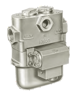

A 3/2 normally closed sensing valve indicates if the valve is functioning improperly. However, the valves generally won’t detect or predict an impending internal failure.

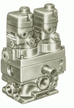

Decades ago, machine builders routinely used simple 3-port, 2-position, normally-closed (non-passing) solenoid valves to help minimize risk during machine operation and servicing. The valves generally had a poppet-type construction, instead of a spool. That’s because poppet valves are less apt to stick in the open position, due to the poppet’s spring and inlet pressure bias to the closed position.
Despite more-robust performance characteristics, however, it is still possible that a poppet-valve element could become sluggish or stick in a partially open (passing) position. Depending on the circuit, such a condition might not be detected during normal machine operation. For instance, if a poppet valve serves as a dump valve and also supplies other control valves, then so long as those other control valves continue to function properly, the machine will operate normally even though the dump valve does not remove the stored energy as expected. The exhausting portion of the circuit would not function as it should, yet operators or maintenance personnel may not be aware of this abnormal condition.
Traditionally, manufacturers used two common methods to overcome this phenomenon. One approach added a monitoring device to the valve, to detect improper functioning. This would typically be a limit, proximity, or pressure switch. Such monitoring devices need to be integral to the valve, designed for safety-related applications, and thoroughly tested.
An add-on monitoring device such as this would, indeed, indicate improper valve function but would not help detect or predict an impending valve failure. The valve could still break down and possibly impair the fail-safe aspects of the circuit. The monitor would merely indicate that the valve had failed. This may still be a suitable fail-safe outcome if the risk is minimal, but it is not generally considered acceptable in high-risk situations.

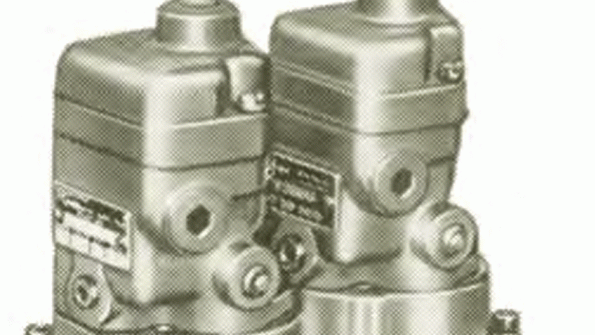

Two redundant valves in series or parallel permit normal equipment operation even if one valve fails.
The second approach involves adding a second, “redundant,” valve in series or parallel with the first valve. With redundancy, a single valve breakdown would not affect normal operation of the circuit, because the redundant valve would perform the required function and maintain normal equipment operation.
The potential problem with this approach is that, again, the loss of functionality of a single valve could remove redundancy from the circuit. Despite redundant valves, the system still depends on a single functioning device to perform normal operations. Redundancy alone provides no assurance that anyone is aware of the loss of redundancy within the circuit, should it occur.

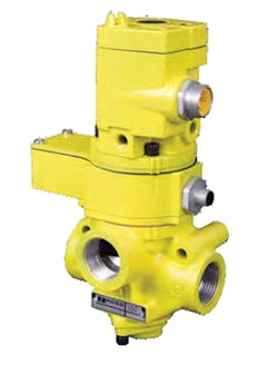

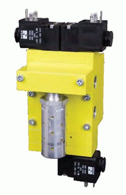

To address these risk modes, fluid-power companies developed valves with two sets of independent yet integrated elements and crossing flow paths. These double valves have the inlets in series but the exhausts in parallel. This provides an AND logic function to the supply portion of the valve elements and an OR logic function to the exhaust portion of the valve. This is the optimal situation in a redundant circuit.
