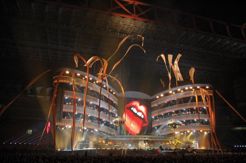

The Rolling Stones' Bigger Bang tour features spectacular stage effects based on innovative use of Festo pneumatic components. This photo shows the equipment in use at the concert held in Milan on July 11, 2006. (Click on image for larger view.)

Air cannons used in the Rolling Stones' Bigger Bang tour fire 30-m fabric ribbons skyward using compressed air. To accomplish the effect, a rotary actuator instantly opens a ball valve to transfer air from a pressurized reservoir to the barrel of each cannon. (Click on image for larger view.)

As part of the finale, 36 air cannons — accompanied by explosive sounds — fire hundreds of 30-m ribbons into the air from the top of the stage set. Each cannon consists of a 20-l reservoir charged with up to 4 to 6 bar of compressed air. Upon command, a rotary actuator opens a ball valve, which instantly routes compressed air from the reservoir into the barrel of the cannon. This 1-m long, 15-cm bore cannon barrel is packed with the multicolored ribbons. Therefore, when the command is given to fire each cannon, a blast of air propels thousands of multi-colored ribbons skyward.

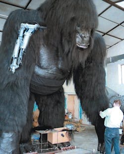

Air cannons represent an application that intermittently and suddenly uses large quantities of compressed air to move a load. In contrast, the animated gorilla shown at right uses pneumatics for continuous motion and force control. Festo supplied multiple components that give life to this 8-m high 2-ton gorilla.
The gorilla pounds its chest and produces facial expressions. Silicone skin covered with Mongolian wool has been peeled away to reveal a pair of pneumatic cylinders that articulate the right upper arm. The figure was manufactured by NPO Ltd., of Semipalatinsk, Kazakhstan.
