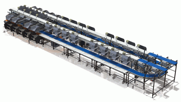

The 60-ft long FSPS-P sizes, sorts, and packages poultry. Rodless cylinders with a low profile and 1.2-m stroke are an integral part of the handling system.
Conveyor belts on either side of the 60-ft long FSPS-P each handle about 180 pieces per minute, explains Doug Barnett, a senior design engineer with Baader. The chicken pieces travel across a moving conveyor scale, where they are weighed on the fly, then move on to one of eight stations along each conveyor, where they are automatically sorted per customer requirements and placed into various-size tray packs commonly found in grocery stores.
Beyond the tray-pack area, the remaining pieces on the two conveyors are discharged to the center of the FSPS-P, creating larger batches that are boxed for shipment, freezer storage, or future processing. Finally, conveyors carry the trays and boxes away.

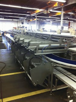

Pneumatics powers much of the sorting and handling at the boxing stations (foreground) and tray-pack stations (rear).
