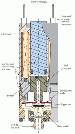

Like its predecessor, the DV consists of three basic subassemblies: housing and solenoid; a base with a nozzle that channels flow; and a “spider” spring assembly that includes a poppet, overmolded seal, and puck-shaped magnet.
Development of the DV was challenging, to say the least, admits Clippard Design Engineer Dave McBreen. His objective was upgrading this basic layout to substantially increase flow capacity, without markedly changing the valve’s overall dimensions.
Though a serious design constraint, small size is a must because users rely on banks of these valves to handle a variety of tasks, he explains. “They’re used in packaging equipment, medical devices, analytical instrumentation, and many other places. Industrial applications typically have multistation manifolds where valves are mounted as close together as possible to minimize space requirements. Thus, the DV valve’s OD couldn’t exceed three-quarters of an inch.”
The first obstacle for the Clippard engineers was designing a solenoid coil that fit the available envelope and could generate sufficient power to shift the valve at high pressures — or determine it was impossible. Product specs called out maximum size, minimum power levels, and maximum flow at standard pressures of 100 psi. And response time had to be in the 10 to 15-msec range to permit high-speed operation.
The question was, how much magnetic force could a coil generate, and how big a magnetic puck was needed to pull against a half-pound preload? “With coil design, it’s all about amp-turns,” explains McBreen. “You get the most bang for your buck by wrapping out and growing your diameter, as opposed to growing taller.” Coil technology hasn’t advanced much since the days of the EV’s development, so McBreen found no magic bullet in the latest generation of solenoids. ”It’s still wrapping wire around a spool,” he says. They did consider voice-coil actuators, but found them too expensive and with unproven long-term reliability. “It was in our design’s best interest to stay with a standard wound coil,” says McBreen.

The DV is a normally closed valve. The poppet with an overmolded seal presses against the nozzle and closes off flow. Energizing the solenoid lifts the magnetic puck towards the core until it bottoms out against the bumper. In the manifold-mount version, air then flows through the #10-32 port, through the orifice, and into the internal chamber. A series of slotted holes surround the molded nozzle, permitting air to flow out to the manifold.

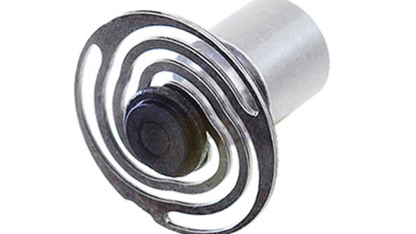

Perhaps the most visually interesting component within the DV is the spider, an unusual spring that shifts the valve when the solenoid deenergizes. Developed by Clippard engineers, the unique configuration lets it generate sufficiently high force from an extremely compact spring with very little movement —the DV has only 0.018 in. of stroke and about 0.018 in. of spring preload. Minimal stroke is necessary, says McBreen, to ensure precise control and maximum flow at operating frequencies as high as 32 Hz.
Getting the configuration just right required intensive FEA analysis in SolidWorks on various spider designs. “We wanted the legs as long as possible, to get the longest stroke within our space limitations,” says McBreen. Thus, the number, shape, length, and layout of the legs, the radii of transitions, and many other factors were studied and adjusted to come up with the proper stroke and spring rate — while keeping stress levels sufficiently low to ensure extremely long life.
The spider spring, with its long, narrow and curving legs, would be difficult to machine or fabricate by stamping, but it is pretty simple to etch, he notes. The process starts with a flat sheet of 0.020-in.-thick 17/7-PH stainless steel, which is then chemically etched to the final configuration. A finishing operation removes stress risers and gives it a glasslike surface. The process holds tolerances on some features to ±0.001 in., so there is little variation from part to part. That helps ensure consistent performance from one valve to the next.

The spider spring shifts the valve when the solenoid de-energizes and has a stroke of only 0.018 in.
