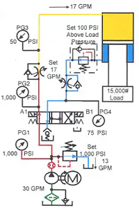

Meter-in flow control of a running-away load
Figures 10-15 and 10-17 show a running-away load controlled by a meter-in circuit and counterbalance valves. The meter-in flow control works exactly as explained previously, while a counterbalance valve makes cylinder movement resistive. (See Chapter 5 for an explanation of counterbalance valves.) Figure 10-16 pictures a bleed-off flow control circuit that gives the same results as a meter-in circuit -- without most of the heat generation.
Fig. 10-15: Meter-in flow-control circuit for vertical cylinder extending with over-running load. Counterbalance valve prevents load from falling.
A meter-in flow control circuit for an over-running load is not the normal design but it may be necessary when the circuit has a pressure switch or a sequence valve.

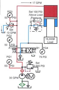

In any meter-in circuit with a fixed-volume pump, the wasted energy will heat the fluid. In the circuit in Figure 10-15, almost 95% of the power used by the system becomes heat. In this circuit, fluid from the pump enters the cylinder as fast as the meter-in flow control allows. A counterbalance valve at the rod-end port keeps the cylinder from running away as it extends.
Fig. 10-16: Bleed-off or bypass flow-control circuit for vertical cylinder extending with overrunning load. Counterbalance valve prevents load from falling.
To save energy while using a fixed-volume pump, the circuit in Figure 10-16 works well. A bleed-off or bypass flow control greatly reduces the amount of wasted energy. With a bleed-off circuit, excess pump flow goes to tank at the pressure required to move the cylinder. In the circuit in Figure 10-16, pressure would be approximately 50 psi as the cylinder extends. The extension-stroke speed is still infinitely variable, while pressure in the cylinder cap end line never goes higher than that caused by load resistance.

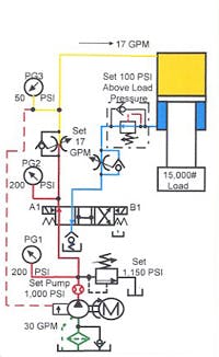

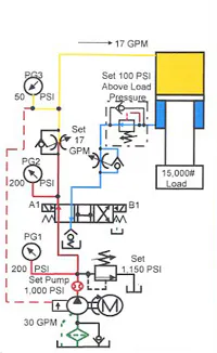

Fig. 10-17: Meter-in flow-control circuit with load-sensing pressure-compensated pump and vertical cylinder extending with over-running load. Counterbalance valve prevents load from falling.
Figure 10-17 shows another way to reduce energy loss and heat generation – using as load-sensing, pressure-compensated pump in conjunction with a meter-in flow-control circuit. A sensing line, teed into the cylinder cap-end line after the meter-in flow control, transmits pressure information to the pump. With a load-sensing, pressure-compensated pump, pressure at the pump outlet stays 150 to 200 psi higher than the load until it tries to go above the compensator’s pressure setting. The only energy loss here is the 150- to 200-psi pressure drop across the flow control at the volume set. (Heat generation within a load-sensing pump circuit is explained later in this Chapter.)

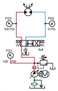

Different locations for flow controls
Figures 10-48 through 10-51 suggest other possible locations for flow-control devices in circuits. Figure 10-48 shows a meter-in needle valve in the pump line. At first, it appears this arrangement results in equal speed in both directions of travel. While it does slow the stroke in both directions, the speeds are not identical with a single-rod cylinder. As the cylinder advances, metered oil flows to the cap-end area (4.91-in.2 for a 2.50-in. bore). With a 1.375-in. diameter rod, the head-end area would only be 3.43 in.2 Thus, with the same flow entering the different areas, retraction speed would be faster.
Fig. 10.48. Meter-in flow-control circuit with needle valve in pump line.
Note that all of the same precautions given previously for meter-in circuits apply to this single meter-in needle valve as well. In addition, some solenoid valves cannot stand backpressure on the tank line, so use caution when applying this circuit.

Fig. 10-52. Meter-in flow-control circuit with fixed-volume pump – cylinder extending.
In the circuit in Figure 10-52, 7 gpm flows across the relief valve at 1000 psi. When this oil reaches system pressure, it flows to tank without doing useful work. If you multiply 0.000583 (7 gpm)(1000 psi)(2545 BTU/hr), the heat loss comes to 10,386 BTU/hr. Add to this the heat loss due to the 3 gpm at 900-psi pressure drop passing through the flow control (4006 BTU/hr). Thus, when the cylinder is moving under the conditions shown in Figure 10-52, more than 14,000 BTU/hr of energy turns into heat. The maximum heat that the unit could produce is 0.000583(10 gpm)(1000 psi)(2545 BTU/hr) or 14,837 BTU/hr. Therefore, approximately 97% of the system’s energy is wasted heating the fluid.
Fig. 10-53. Meter-in flow-control circuit with pressure-compensated pump – cylinder extending.
The pressure-compensated pump in Figure 10-53 produces only the flow needed, so there is no oil going over a relief valve. The only heat loss in this circuit is the 900 psi across the flow-control valve. There are 10,000-BTU/hr fewer entering the system just by changing the type of pump.
Fig. 10-54. Meter-in flow-control circuit with load-sensing, pressure-compensated pump – cylinder extending.
To cut even more heat from the system, the circuit in Figure 10-54 uses a load-sensing pressure-compensated pump. This pump has a sensing line that monitors the pressure required to move the cylinder, then sets the compensator 150 to 200 psi higher. With a 100-psi cylinder requirement, the pump would operate at approximately 250 psi. This low pressure drop across the meter-in flow control generates a heat loss of just 668 BTU/hr.
To sense the load at both ends of the cylinder, or if there is more than one cylinder to control, the sensing lines come back to the pump through check valves. These check valves allow the pump to see the system’s highest pressure requirement and set the pump pressure 150 to 200 psi above it.
When using a load-sensing pump, always use a meter-in flow-control circuit. A meter-out circuit shows pressure at both ends of the cylinder all the time it is moving. With pressure at the load-sensing port, the pump would go to compensator setting and stay there. (For more information on load-sensing pumps, look in Chapter15.)
Fig. 10-55. Meter-in flow-control circuit with variable-volume pump – cylinder extending.
Heat generation for the circuit in Figure 10-55 is the lowest possible when variable speed is necessary. In this circuit, a variable-volume pump set for 3-gpm flow replaces the flow controls. Because the cylinder uses all the flow produced, system pressure only goes to the 100 psi required to move the cylinder. There is no excess horsepower, so no heat is generated. (In actual practice, pump inefficiency, pressure drop in the lines, and friction between parts generate some heat. These losses may cause the system temperature to rise 5 to 15° above ambient temperature.)
When practical, a variable-volume pump provides the best way to control actuator speed. Variable-volume pumps may require some electronic controls if there is more than one cylinder, but lower operating cost for the life of the machine quickly offsets this one-time first cost.

Controlling speed of hydraulic motors
Figures 10-64 through 10-67 show schematic diagrams of flow-control circuits for hydraulic motors. The circuits in Figures 10-64 and 10-66 are the best for this purpose. In both of these circuits the motor only has pressure on one port. This arrangement provides the motors’ internal leakage with a path to tank at minimal backpressure. High backpressure in a motor can cause wear on the motor shaft seal and leakage. Motors with external case drains eliminate high case backpressure at both ports, but motor drain flow increases.
For a running-away load, the schematic diagram shown in Figure 10-65 is best. When using a meter-out circuit, specify a high-pressure shaft seal due to backpressure at the motor outlet port. A case drain to let internal leakage go directly to tank can take the place of the high-pressure shaft seal, and is preferred in most cases.
Fig. 10-64. Meter-in flow-control circuit for hydraulic motor.
The bleed-off circuit in Figure 10-66 will generate the least heat of the first three. The only problem is that the motor will slow a little as pressure increases -- due to pump and motor inefficiency. The pressure-compensated flow control will maintain a constant bypass of fluid as pressure climbs. However, pump output will decrease and motor bypass will increase, causing the motor to slow. Use high-efficiency components to keep this speed change minimal.
Fig. 10-65. Meter-in flow-control circuit for hydraulic motor. (Requires high-pressure seals and case drain, as shown.)
The circuit in Figure 10-67 is the most efficient of the four in this section. With a variable-volume pump, pressure is always just what the load requires, backpressure is negligible, and heat generation is minimal. To obtain very accurate control, use a servo-controlled pump with electronic feedback from the motor.
Any of the flow-control circuits for cylinders works well with motors. The main difference is dealing with leakage. Most cylinders have dynamic seals that do not leak. Also, there are no areas to trap internal leakage in a cylinder.

Fig. 10-67. Meter-in flow-control circuit for variable-volume pump supplying hydraulic motor.
