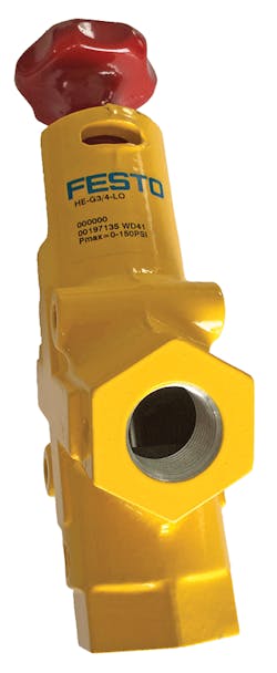

6. Tamper-Proof Shut-Off Valves
Lock Out Tag Out valves make it impossible to restore pressure while locked in place.
Tamper-proof “Lock Out Tag Out” (LOTO) valves manually shut off and vent pneumatic systems. These large and rugged LOTO valves are easily recognized because they’re bright yellow. While the tamper-proof valve may be used in emergency situations, it is mainly used during machine maintenance to ensure no active pressure is present.
Once pressure has been evacuated, maintenance personnel insert a lock or hasp in the valve, making it impossible to restore pressure while the lock is in place. Depending on pneumatic configurations, there may be several tamper-proof valves per machine. These valves are OSHA-compliant.

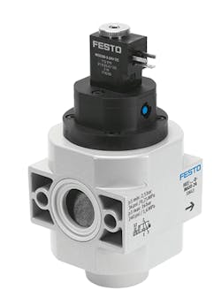

7. On-Off Valves with Piston Sensing
An on-off valve with piston-position sensing confirms whether a valve is on or off.
Unlike manually operated tamper-proof valves, a PLC electronically controls solenoid-actuated on-off valves with piston-position sensing. These units sense piston position and confirm the valve is either on or off. Other electronically controlled pneumatic on-off valves do not offer this feedback. Position sensing provides an extra margin of safety monitoring, and on-off valves can be integrated into a system to achieve a higher-category safety rating. Furthermore, these units mount directly to air-preparation modules for easier and more-straightforward installation.

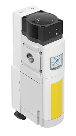

8. Emergency Quick Exhaust
Emergency quick-exhaust systems vent air from circuits at extremely high rates.
The emergency quick-exhaust system is the type of unit most people think of when they visualize a pneumatic safety product. When a penetrated light curtain or an open guard, gate, or door activates an emergency stop switch, these PLC controlled units exhaust air from the system at rates up to 9,000 liters/min—effectively removing pneumatic pressure. These systems should meet redundancy safety guidelines under ISO 13849-1.
These units should also protect against unexpected startups and provide for safe pressure buildup. At startup, a unit must receive two signals offset by milliseconds from the PLC. Offsetting the signals prevents startup due to a short circuit. Once the unit receives the two enable signals, it slowly lets pressure build in the system so that actuators safely complete the cycle that was interrupted by an emergency shut off.
The optimum unit in the “tool kit” should come standard with built-in diagnostics, freeing the OEM from having to provide its own diagnostic system. These units are typically certified by a third party to meet Performance Level e/Category 4, which also saves the OEM considerable time and expense.

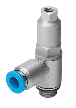

9. Piloted Check Valves
A piloted check valve retains pressure in a cylinder and holds it in place. It’s particularly useful in vertically mounted actuators.
When air pressure is turned off, pneumatic pistons facing up may retract back into a cylinder and pistons facing down may fully extend. These movements may damage the machine, part, or people. A piloted check valve retains pressure in the cylinder, stopping it and holding it in place. Some models, for example, come standard with a manual override, which lets maintenance personnel evacuate air from the cylinder when it is judged safe to do so. Piloted check valves are useful for both emergency situations and for safety during maintenance.

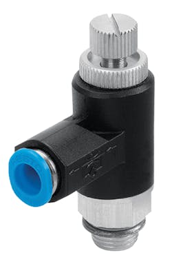

10. Tamper-Proof Flow Controls
Tamper-proof flow-control valves protect against unauthorized resetting of flow rates.
Flow-control valves are simple screwdriver-adjustable needle valves that control air flow. Technicians can open a valve for more flow and dial it down for less air. The potential problem with flow-control valves is that operators and maintenance personnel may tinker with valve settings for on-the-fly adjustments to air flow. A change in flow may appear to make a machine run faster or perform better, but it can damage parts by increasing wear and even causing unexpected safety problems.
Festo’s GRLA-SA economical exhaust air-flow control valves provide an ingenious solution—a spring pin protects against the unauthorized resetting of volumetric flow rate. It is as simple as that.
