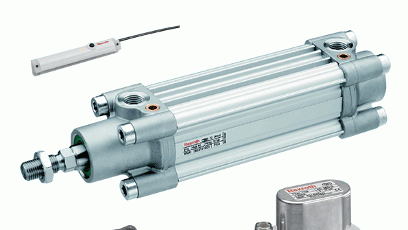

Typical components of an EPPS system include a pneumatic cylinder, ED02 electropneumatic pressure regulators, an EPPC position controller, and an SM6-AL sensor. It uses direct-acting proportional pressure control to enhance positioning accuracy and system efficiency.
