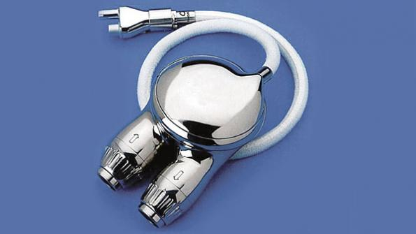

Thoratec’s Implantable Ventricular Assist Device uses reliable pneumatics to keep patients alive when their own heart is to weak to do so. Click on image for larger view.

For more than 30 years, Thoratec Laboratories Corp., Pleasanton, Calif., has been developing and manufacturing advanced medical technologies to improve patient survival and quality of life. Its Implantable VAD is the only implantable biventricular support option for advanced heart failure patients requiring months or years of support, and Thoratec’s VADs are the first and only biventricular support systems approved for home discharge.
Thoratec’s Implantable VAD consists of three main components:
• blood pump, which takes the place of one or both of a patient’s ventricles,
• TLC-II pneumatic driver, which consists of an air compressor, controls, valves and other components, and
• cannulae, a network of tubing that routes air between the blood pump and pneumatic driver.

Air from the pneumatic drive travels to the patient through about 5 ft of ¼-in. flexible tubing and into the blood pump. Click on image for larger view.
Lee continued that from the pneumatic drive, air travels to the patient through about 5 ft of ¼-in. flexible tubing. The air then flows into or out of the blood pump. Lee explained, “There is only a single pneumatic lead (tube) connecting the blood pump to the driver, where the air is shuttled between positive and negative pressure (vacuum) to help assist the blood sac (pump) during filling and ejection.”
The main component of the pump is a blood sac. Blood flows into this sac and is pushed out by the pump. Biomedical quality check valves ensure that blood only flows into the sac during filling, and only flows out during ejection.
Lee continued, “The air from the pneumatic driver does not contact the blood sac directly. Instead, a diaphragm separates the air chamber in the pump from the blood sac. So in the unlikely event that the diaphragm is compromised, there still is a safety barrier to prevent air from getting into the blood sac. The diaphragm and blood sac are both made from our proprietary, polyurethane-based polymer that can endure several million cycles of deflection needed to support patients for several years.”
