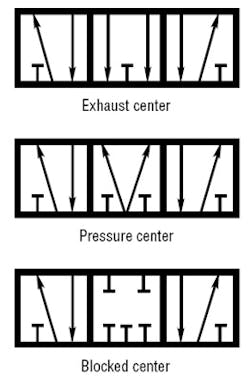

The center position of a 3-position valve satisfies other system requirements. (The center position also is commonly referred to as the neutral condition.) There are a variety of center conditions available with 4-way directional valves, Figure 2. The most common center conditions are: pressure center (with both cylinder ports open to pressure), exhaust center (with both cylinder ports open to exhaust and pressure blocked), and blocked center (with all ports blocked).
Figure 2. Graphic symbols for most common center positions of 5-ported, 4-way directional valves.
The pressure-center type of valve might be used to alternately control the motion of two or three groups of singleacting cylinders. When the valve is in its center or neutral position, pressure is directed to both cylinders, causing both to extend. If the valve is shifted to either extreme position, one cylinder group retracts while the other remains extended. When the valve is shifted in the opposite direction, the motion of the cylinder groups is reversed.
With the exhaust-center condition, the double-acting cylinder is free to float with the valve in its neutral state, because both ports of the cylinder are opened to exhaust. The cylinder rod can be moved manually (subject to internal friction and external loading).
The blocked-center condition blocks all working ports and often is called closed center. Depending on the circuit design and cylinder loading conditions, this center condition may provide a holding action on the device to which the valve is connected. With suitable controls — and taking into account the compressibility of air — this type of valve can stop a cylinder at intermediate points along its stroke as it travels in either direction.

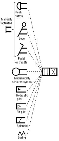

Directional-valve actuators
Directional valves’ movable members can be shifted to their positions by manual, mechanical, electrical, or pneumatic actuators, Figure 3. When directional valves must be controlled at an operator’s discretion, his or her muscle power is used on a manual actuator. Mechanical actuation is chosen when the shifting of a directional valve must occur at the time a cylinder physically reaches a specific position.
Figure 3. Schematics of common valve actuators.
Directional valves also can be remotely shifted with air or electricity. In air-operated valves, pilot pressure is applied to the spool ends or to separate pilot pistons. In electrically operated valves, a solenoid responds to an electrical signal (AC or DC, depending on design) and physically displaces the valve’s moving member.
Solenoid actuation is perhaps the most common way to shift pneumatic directional valves because electrical and electronic controls for so many other machine actions are readily available and popular. These controls can easily integrate the air-valve solenoids for sequencing and automation.
