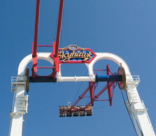

Two powerful, 28-in. bore cylinders use 1275 cfm of air at 120 psi to propel two giant swings 125 ft into the air on Cedar Point's new ride, the Skyhawk.

Seating 40 people — 10 on each side of two large arms — the Sky-hawk swings riders up to 125 ft into the air at speeds of 60 mph or more. The one-minute ride peaks at seven swings, giving riders a chance to look straight up into the sky, out over Lake Erie, or straight down to the concrete below.

A single loop of high-strength steel cable transmits force from the cylinder to a sheave that applies torque to drive the swing arm. Essentially, then, the assembly acts as a giant rotary actuator. A sheave at the bottom of the tower acts as an idler, and additional sheaves help keep the cable stable. Jacobi says the cable cannot become slack, which is achieved by pre-tensioning the wire rope. Because it's a loop, the tensions oppose each other. Air flowing into one end of the cylinder increases cable tension at that end but decreases tension at the other end, and the pre-tensioning prevents any part of the loop from going slack.
