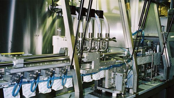

Pneumatics can be particularly effective for any kind of machine motion that combines or includes high-speed, point-to-point movement of the types of products with the weight and size dimensions typically found in packaging machines. This includes indexing, sorting, and pick-and-place functions. It is also used for suction cups or non-contact transfer devices.
For example, pneumatics can drive multiple functions on cartoning machines: indexing the infeed of blank cartons onto the process line; driving machine components that help form the folds; closing those folds; and moving glue guns or other sealing devices. In form fill and seal machines, it’s common to have pneumatics drive clamping devices and heat sealers, as well as tension controllers on rollers discharging the plastic film that forms the bags being sealed.
