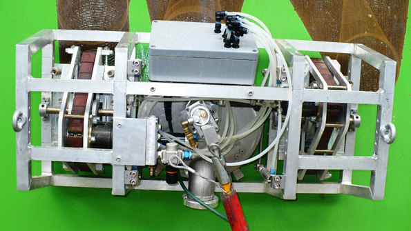

Kamat’s SHC 3000 ship hull cleaner comes with a protective aluminum cage as well as safety cables for additional personnel protection.

This photo shows the two track drives the SHC 3000 uses to maneuver along a ship’s hull while cleaning.

The SHC 3000 uses high-pressure guns equipped with rotating nozzles for quick and versatile cleaning of surfaces. It is housed in an aluminum frame, and the swivel nozzle assembly can be removed and used on its own for small jobs or for working in confined spaces. The swivel assembly is rotated by an air motor to provide high-pressure cleaning of large areas. The rotational speed of the air motor is controlled proportionally to achieve optimum cleaning effectiveness.

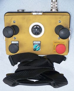

The SHC 3000 is easily controlled remotely using a user-friendly joystick design.
The crawler itself is held securely against the ship’s hull or other steel surface by four rows of strong magnets positioned close to but not touching the steel surface. This is important because reaction forces from the high-pressure water jets would act to push the machine away from the surface.
The crawler also uses pneumatic motors to move around the steel surface through a crawler drive—similar to what is used in skid-steer loaders. Each of two pneumatic motors drives a sprocket that engages a plastic-coated chain. Each chain is driven independently in either direction. Turning is accomplished by driving one motor faster than the other, and the crawler can even rotate on its own axis by driving one motor forward and the other backward.

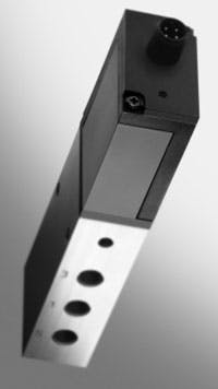

Direction and speed of each motor is controlled proportionally by a 5/3 way, normally closed valve, specifically, Festo’s MPYE-5-178HF-010-B. Speed can be controlled from 0 to 4.5 m/min (0 to 14.8 ft/min), and a higher speed range 0 to 9 m/min (29.5 ft/min) is offered by Kamat as an option. Because the crawler operates via remote control, the user is at a safe distance from the working area.
A pair of Festo MPYE 5/3 normally closed proportional valves vary air motor speed to produce track drive speeds from 0 to 4.5 m/min (0 to 9.0 m/min as option).
