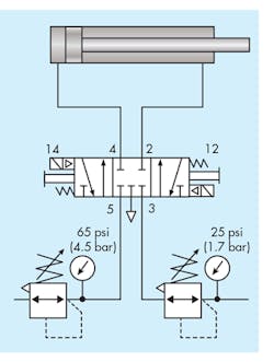

Another configuration for obtaining dual pressure is shown in Fig. 4. It operates on the same principle that many types of 5-ported, 4-way valves use with dual pressure supplies. Compressed air enters one end of the cylinder at high pressure, and the other end is supplied with air at a lower pressure. In essence, a double-acting cylinder extends at high pressure and retracts at low pressure. This is accomplished using a dual-pressure, 3-positon, 5-ported, 4-way, directional valve with a blocked center. In Fig. 4, the valve is supplied high pressure at port 5 and low pressure at port 3. The exhaust port is common to both.
5. Installing regulators at both inlets to an air motor controls torque separately for clockwise and counter-clockwise rotation. In this case, both regulators have full reverse-flow capability.
When solenoid (14) is energized, pilot air pressure shifts the main valve spool to connect ports 5 and 4, causing the cylinder to extend at high pressure. De-energizing the solenoid (14) causes the opposite return spring to center the valve. Energizing solenoid (12) directs pilot pressure to shift the valve spool to connect ports 3 and 2, causing the cylinder to retract at low pressure. Dual-pressure circuits are known for their energy efficiency. Using high-pressure air only when needed reduces compressed air consumption and, hence, the energy to compress the air. These systems cycle thousands of times per day in most applications, and most machines use multiple circuits. Consequently, the lower energy use from multiple circuits and thousands of cycles quickly repays the initial cost; it continues providing lower operating costs for each application.

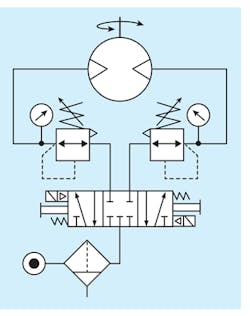

Torque Control of an Air Motor
Sometimes an air motor requires variable torque capability. The magnitude of torque depends on the pressure at the motor inlet, whereas speed depends on the air flow. Figure 5 shows a motor circuit where the bidirectional motor torque can be different for clockwise and counter-clockwise rotation. Two secondary regulators are placed between the motor and the directional valve, which has a 5-ported body and 3-position, 4-way spool with  blocked center. The secondary regulators must have reverse flow capability or check valves to bypass exhaust flow past each the regulator during reverse-flow conditions.
6. Placing the regulators upstream of the directional valve that uses a common exhaust port eliminates the need for using reverse-flow regulators or check valves to accommodate exhaust flow.
Reverse flow through regulators can be avoided with the circuit shown in Fig. 6. It consists of the same components, but now the secondary regulators are connected to the 5 and 3 ports of the directional valve. The same torque can still be accomplished by converting the directional valve into a dual-pressure supply valve.
What if a machine requires variable torque with the motor rotating clockwise, counter-clockwise, or both? This is where electropneumatic regulators provide versatility. Electropneumatic regulators provide variable output pressure, so motor torque can be matched to load demands. And depending on their sophistication, electropneumatic regulators can even follow a command signal, making them useful for continuous machine control.
