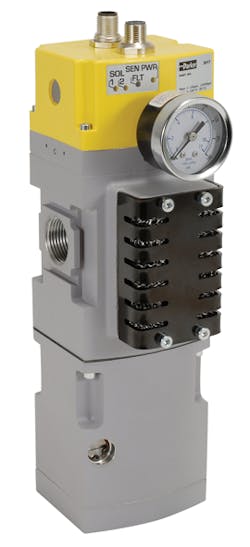

For example, in the new P33 valve from Parker Hannifin (Fig. 5), this is done by monitoring the condition of pressure-operated sensors in the valve. These sensors are hardwired into the controls and “monitored” by the external control system. This is generally done with most versions of safety relays and safety PLCs that can also perform pulse test monitoring.
These types of safety relays and safety PLCs make for very reliable systems with high diagnostic coverage—especially, short circuit faults in dual channel systems. The use of sophisticated controls and monitoring ensures sensors are not bypassed and the valve is functional.
5. Parker Hannifin’s P33 safety exhaust valve, designed for external monitoring, incorporates series-parallel technology for high flows and fast exhausting response with minimal residual pressure in the fault condition. A B10d of 20,000,000 cycles ensures long life. It is compatible with most brands of controls and can be used with a safety relay, programmable safety relay, or high-end safety PLC.
