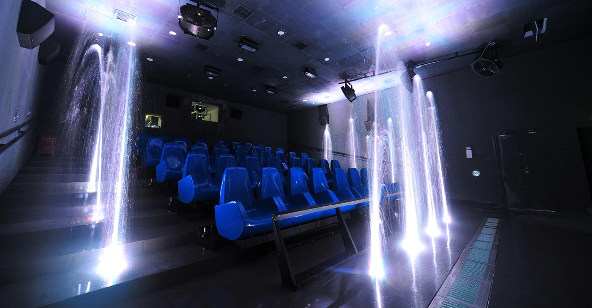

In Europe, 5D theaters have been established for some time. Now, experience theater is being taken to the next level. Yas Waterworld, the world’s first water park theater, opened in Abu Dhabi this past spring. This 5D theater not only floods, but also produces movement simulation in the water that is synchronized with visual, audio, and other presentations.
Yas Waterworld, recently opened in Abu Dhabi, relies on pneumatic valves and actuators to produce synchronized motion of theater seat while frequently submerged under water.

The Yas Waterworld water park is the first water park theater with flooding and other special effects. It provides the experience of being right in the middle of a theater that is suddenly flooded with water, where moviegoers are immersed in warm water up to their waist. Water rises from below, flooding the theater matching what is happening in the movie. Wave machines perfect the illusions, rounded off with waterfalls that flow to the left and right of the screen. Attraktion! is working on a second project of this type, set to open in Guangzhou, China. It will also use pneumatic components from AVENTICS.
