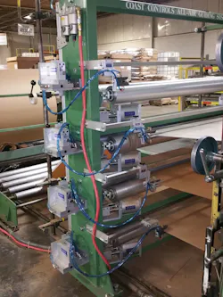

At Coast Controls, we manufacturer the world’s only proportional pneumatic web guiding system (Fig. 1). The machines use the same medium—compressed air—for sensing, controlling, and powering the actuating devices. The complete system consists of the All-Air servo controller, which processes signals from an airflow sensor to extend or retract a pneumatic cylinder on a guide assembly. We have used the same proportional controller on every system we have built since 1992, whether it is a displacement, steering, or shifting unwind/rewind guiding system. It is a time tested, proven design to say the least.
1. This machine handles up to four layers of laminated paper for making pet food bags. Here, three layers are brought together for subsequent gluing, folding, and cutting. The machine uses four all-pneumatic web-guiding systems that ensures that all high-speed webs remain in precise alignment.

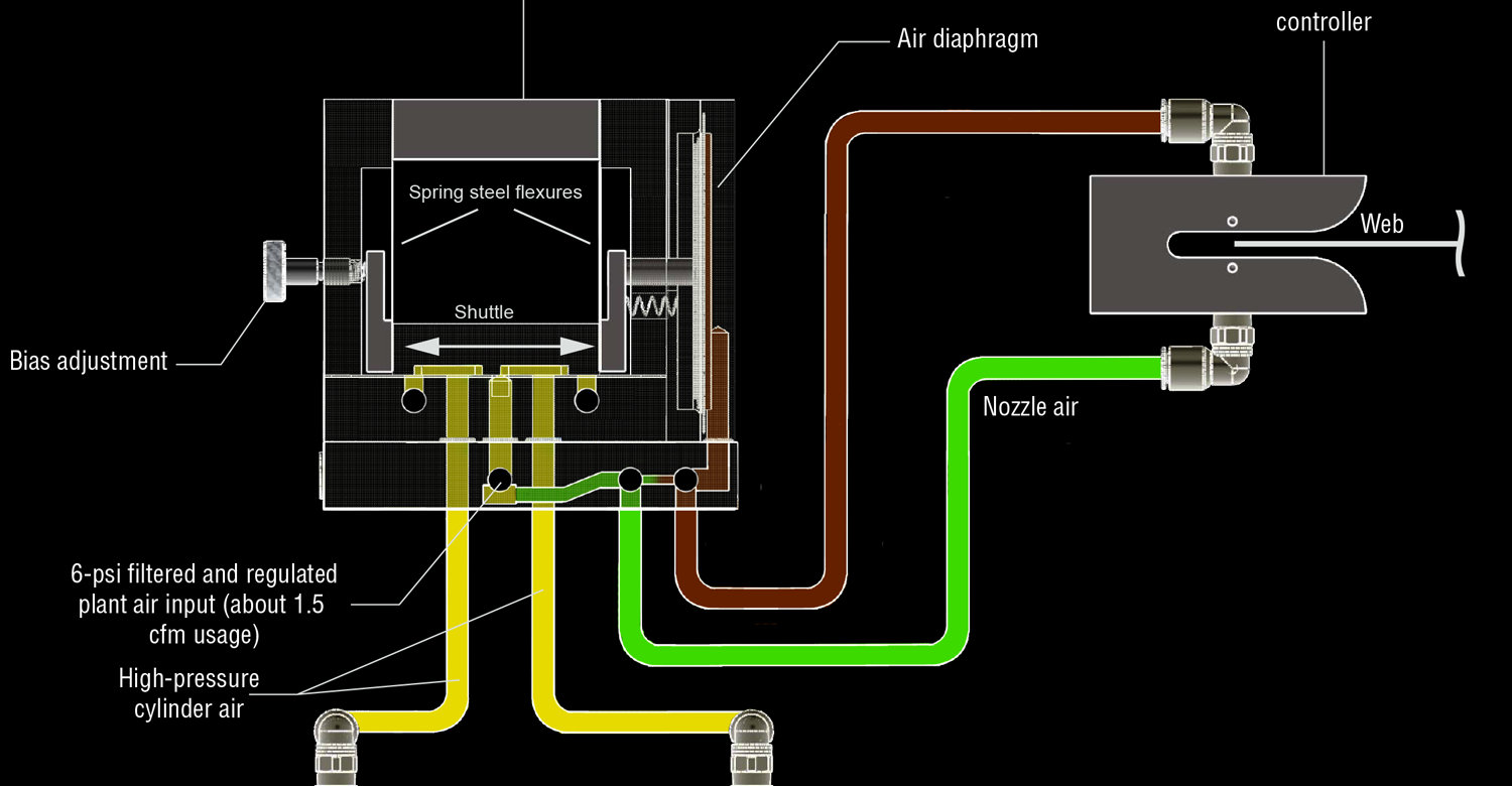

The air-flow sensor (Fig. 3), installed downstream from the guide, is the essence of simplicity. It consists of a sensor body with a slot for the edge of the web and opposing nozzles. Low-pressure air from the servo controller flows constantly into the nozzle at the bottom. Depending on the web’s position in the slot, it creates different backpressures at the opposing upper nozzle and, consequently, at the servo controller. To prevent dust or other foreign matter from clogging the air-flow sensor, the system provides for a continuous positive air bleed from both the opposed nozzle and signal orifices.
3. Cross-sectional view of simple, self-cleaning, non-contact sensor that straddles edge of web. Correctly positioned web partially blocks air flow between nozzles to establish neutral signal pressure.

The All-Air servo controller (Fig. 4), is based on a friction-free design incorporating a moving shuttle suspended by two spring-steel flexures. These flexures position the shuttle to maintain a 0.002-in. clearance between it and the port plate underneath it. This configuration allows for almost-effortless shuttle movement and avoids any shuttle wear. Pressure signals from the air flow sensor impinge on the diaphragm at the right side of the controller. When the diaphragm develops enough force to compress the bias spring at the opposite end of the shuttle, the shuttle strokes and directs proportionally higher-pressure air to the proper end of the pneumatic cylinder. The cylinder’s stroke moves the guide to return the moving web of material to its proper position.
4. A diaphragm responds to the return signal from sensor and interacts with springs to position a shuttle within the servo controller to send a pressure signal to the appropriate end of cylinder that will correct web position.
The controller is adjusted so that the shuttle’s neutral position is established when the web edge partially blocks air flow between the two ports in the sensor. The system deadband width is between 0.003 to 0.005 in. at the air-flow sensor. When the web wanders to the left, exposing more of the upper nozzle, return pressure increases, and the diaphragm flexes more, pushing the shuttle to the left. Should the web drift to the right, it will block return flow completely, allowing the diaphragm to relax, and the bias spring pushes the shuttle to the right. The resulting proportional pressure signals to the cylinder automatically reposition the web until its position in the sensor brings the shuttle back to neutral. No action is required by the operator.
In effect, the air-flow sensor, All-Air servo controller, and pneumatic cylinder—along with the moving web of material—combine to form a closed-loop proportional control system. The servo controller converts and amplifies the return signal from the air-flow sensor to a higher pressure and sends the desired correction to the air cylinder. The cylinder then strokes to reposition the guiding assembly and accurately aligns the moving web.
