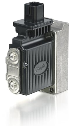

Actuators Come with Spool Position Feedback
The PVE series 7 actuators feature a “plug-and-perform” design that works with the company’s high-performance proportional valves (PVG 32, PVG 100, PVG 120, and the new PVG 128 and PVG 256), as well as its steering valves (EHPS, EH, EHi, and OSPE). A spool-position sensor equipped with a dual demodulator provides spool-position feedback to make sure valves are in their correct position at a given input signal. Built-in safeguards include fault monitoring, optional spool-direction indication, and separate float control. They are backwards-compatible with PVE Series 4 actuators, offering more space around the valve, a microcontroller with embedded software algorithms to increase repeatability, and an wider temperature range from −40 to 90°C.
Danfoss Power Solutions, (515) 239-6000, www.powersolutions.danfoss.com

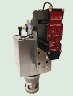

Proportional Flow-Control Valves Feature On-Board Electronics
Measuring 16 to 50 mm, these proportional flow-control valves come with standard ISO 7368 and DIN 24342 cavity and porting. Response time is 4 ms,  and they can close the poppet under high load pressure. On-board electronics require a 0- to 10-V command for proportional control from a 24-V supply with a minimum of 3 A. No amplifier card is needed.  Minimum pilot pressure is 40 psi, and if the voltage or pressure drops below those requirements, the valve will shift to safety mode.
 Almo, (877) ALMO-NOW, www.almomanifold.com
