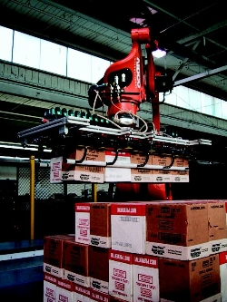

Designing or implementing a vacuum system for an important and often costly expenditure can cause many decision makers to encounter mixed messages, making the right choice unclear. In order to ensure a profitable investment, engineers should consider reliability, product safety, efficiency, response time, flexibility, and maintenance issues. Although several different types of vacuum systems exist, this article examines and compares the different characteristics of centralized and decentralized systems.
Centralized and decentralized systems
A centralized vacuum system consists of one vacuum source — usually a mechanical piston or vane type vacuum pump — mounted remotely and providing vacuum to multiple use points. This setup often serves as a plant-wide supply of vacuum provided by the single vacuum pump. Other examples include individual machines having their own dedicated vacuum pump, or a system where a machine may have pockets, or cells of multiple vacuum cups operating from a single vacuum pump. A centralized system is a common, traditional solution that is easy to integrate into a design and is easy to install.
A decentralized system places vacuum sources closer to the points of use. The typical vacuum source for these systems is a vacuum generator, which produces vacuum by routing compressed air through a venturi. Decentralized vacuum systems can range from a zoned network, where groups of vacuum cups that work together are isolated, Figure 1, to a system where each cup operate independent of each other. Advances in pump design allow for a vacuum generator to be installed at each vacuum cup. Decentralized systems also are easy to incorporate into a design and are easy to install. In many applications they can boost productivity through quicker response and save energy at the same time.

A vacuum system's reliability and safety relate to developing enough vacuum to pick up parts successfully and not drop them. With a centralized design, all vacuum cups are tied together into one volume. Therefore, when a low flow or low vacuum situation occurs, it affects all the cups in the system.
For example, if one cup is damaged, or leakage is otherwise present, the resulting vacuum loss will be seen at every cup in the system. Troubleshooting such an event is more difficult because the symptoms occur throughout the entire system, making it difficult to identify the source of the problem.
Conversely, with a decentralized system, each pump and cup combination works independently. Therefore, a leak at one cup has no influence on any other. Furthermore, a leak at any cup can be quickly identified and fixed.
