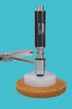

To accommodate the physical characteristics of cake, Vaccon developed a round, rigid plastic cup with mesh screening. This provides a large surface area for suction, creating a vacuum head able to spread the vacuum over the entire top surface area without marring or dimpling the cake.
The goal was to develop a pick-and-place handling system for inserting the 10-in. round cakes and slip sheets into corrugated shipping cartons. The new machine would need to place 8 to 12 cakes with slip sheets into cartons at a rate of at least two cakes per second. And due to space constraints, placement of the cakes and slipsheets would have to be downward along the machine’s Z-axis.

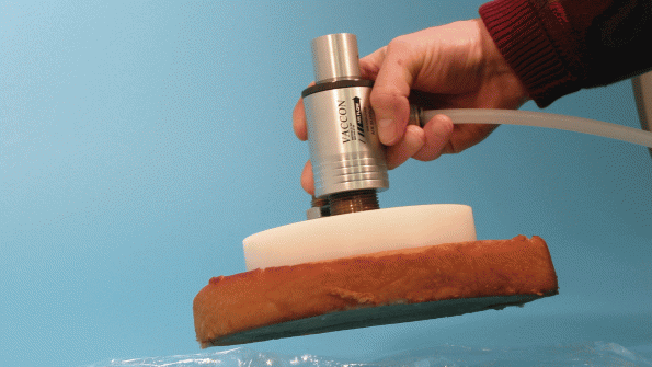

An aluminum CDF 750 air amplifier provides vacuum, and the through-flow design allows cake crumbs to pass through without clogging. The attached black-aluminum silencer ensures a quiet working environment.
Vacuum flow is free air induced by a vacuum pump. When that air is constricted, it creates vacuum, the level of which is measured by the amount of constriction. The vacuum level is highest when the flow of free air is completely blocked. Because the cake is delicate and porous in this case, tightly controlling flow is crucial to generating a vacuum level high enough to hold the cake, but low enough to keep it from damaging the surface.

To accommodate the physical characteristics of the product, Vaccon developed a 6-in. diameter rigid cup composed of ultrahigh-molecular-weight polyethylene with mesh screening. The screening creates a greater surface area for suction, generating a vacuum head able to spread the vacuum tension over the entire top surface area of the cake without marring or dimpling.
Conventional vacuum and vacuum cup technology damages delicate, “crumbly” products like cake.
A continuous vacuum flow is delivered by Vaccon CDF 750H adjustable air amplifiers with solenoid valves added for instant on-off control for pick-up and release. This is not a hard vacuum that must be released, but continuous flow and pressure controlled via solenoid valves.
The Vaccon-developed vacuum head and air amplifiers are mounted on an arm that moves the cakes from the end of the production line over the shipping carton and lowers them into the carton. The same process is applied to the slip sheets between the cakes.
The CDF adjustable air amplifiers operate based on the Coanda effect, where a small volume of compressed air is converted into a high output flow. Compressed air is emitted from an annular gap and passes over a curved surface in the throat of the unit. As air passes over this curved surface — similar to an air foil — a low pressure area is created that induces ambient air to flow into the throat with the compressed air.
Amplification ratio is up to 40:1, so the CDF amplifiers are a cost-effective alternative to using raw compressed air. The CDF amplifiers are also energy-efficient, unlike regenerative blowers that must run continuously. Incorporating the solenoid valve for the instant on-off control means the CDF need only be on when air is required.
The CDF air amplifiers’ straight-through design allows debris — in this case, cake crumbs — to pass through without clogging, providing maintenance-free operation. In addition, there are no moving parts to wear.
