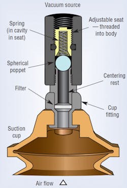

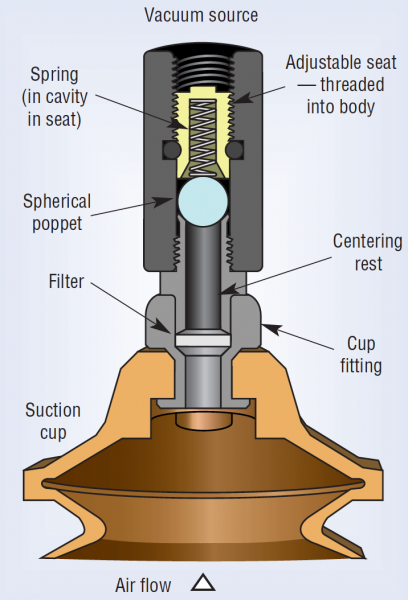

Spherical poppet inside Flow Sensor Valve is centered in close-fitting bore on pedestal-style rest. Bias spring normally holds poppet open. Air being drawn into valve passes through notches in rest, through annulus between poppet and bore, and then past seat. When flow force exceeds spring force, valve closes — and remains closed until vacuum source is removed.

By using a flow meter, FSVs can be tuned to close at a particular flow rate. This is done by adjusting the distance from the FSV’s poppet to the seat, which also changes the bias-spring force that holds the poppet against the rest. (The seat can be repositioned with a screwdriver.) The valve should be set so that normal vacuum flow — when the cup is sealed against a work piece — is less than the setpoint flow. The valve then will remain open during normal operation and close only when flow becomes excessive.
