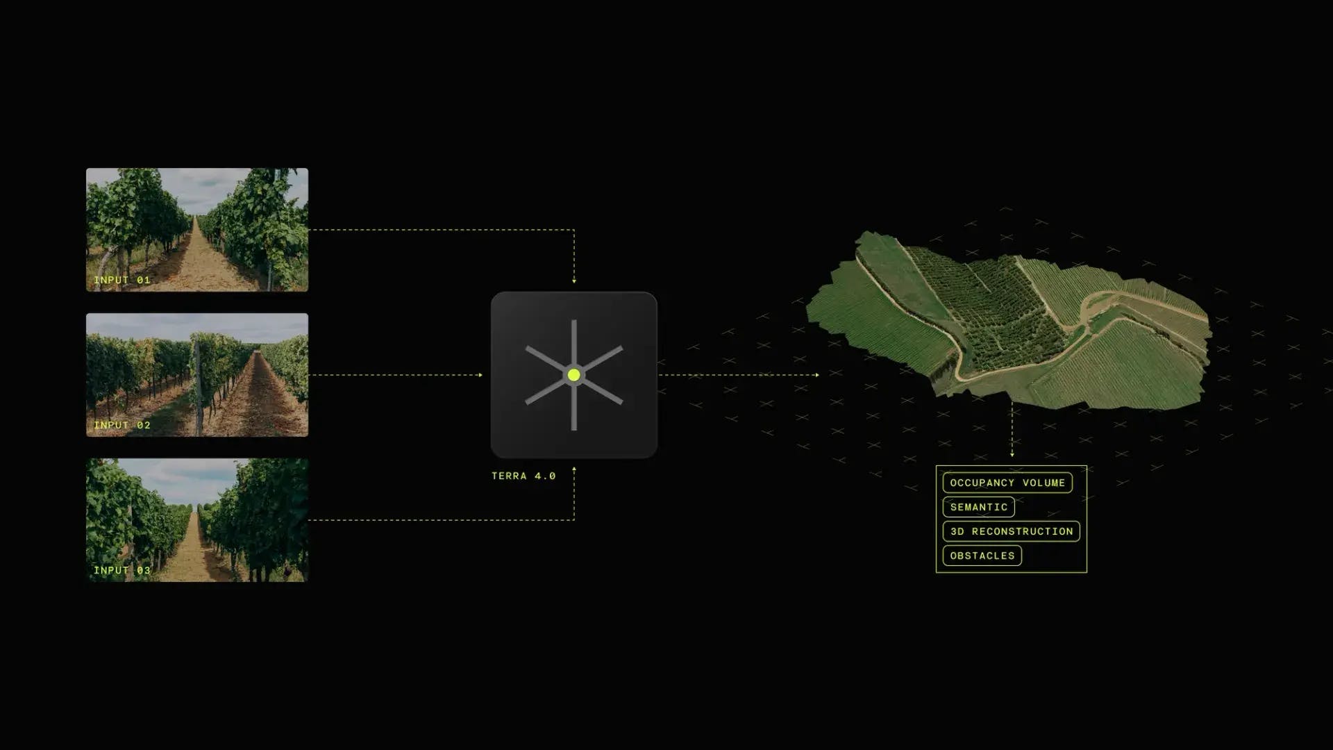

Autonomous robots in the agriculture sector heavily rely on various sensors to navigate and execute tasks efficiently. To create a more cohesive system with these sensors, Stereolabs – a developer of vision-based sensing technology – created Terra AI, a general-purpose artificial intelligence (AI) technology.
Through its use of artificial intelligence, the Terra AI technology enables new approaches to sensor integration, volumetric perception, and computational capabilities to improve visibility, and thus safety and precision, of robots and other autonomous vehicles used in agriculture as well as a range of other industries.
According to Cecile Schmollgruber, CEO and co-founder of Stereolabs, Terra AI consolidates the functionalities of multiple specialized sensors into fewer, more versatile sensors or cameras. “This integration means that the same cameras can perform tasks like surround vision, obstacle detection and high-resolution analysis, which were previously handled by separate devices,” she said.
This approach offers benefits such as cost-effectiveness, simplified management and increased reliability. “Reducing the number of sensors needed for autonomous robots directly translates into lower costs,” she said. This is particularly beneficial for scaling operations where the cost of equipping numerous robots can add up.
With a unified vision platform, she said the complexity of managing and maintaining multiple sensors is significantly reduced. “This simplification leads to easier integration, troubleshooting and updates,” said Schmollgruber. “A single, well-integrated system is often more reliable than a multi-sensor setup, as it minimizes potential points of failure and compatibility issues between different types of sensors.
“Terra AI represents a strategic shift towards a more integrated, efficient and cost-effective multi-camera vision system for autonomous robotics, similar to ADAS [advanced driver assistance systems] for cars,” she added.
READ MORE: Harvesting the Benefits of Autonomous Agricultural Machinery
Data Fusion Creates Better 3D Models
Terra AI utilizes multi-camera setups that cover a 360-degree area to generate a 3D model of the environment. “By fusing this data in time and space, Terra AI generates a complete 3D model of the environment with higher confidence,” Schmollgruber said.
This helps deliver benefits such as higher accuracy in depth and motion estimation; increased redundancy — if one camera fails or encounters issues, the others can continue providing in-depth information; robustness to occlusions; and versatility and flexibility — multi-view setups offer greater flexibility in camera configurations, allowing for customization of the camera placement according to specific application requirements.
