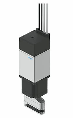

Festo developed its EHMD Rotary Gripper to help minimize the reliance on manual processes still utilized in many laboratory settings. The gripper can grip and rotate small objects infinitely, enabling it to be used as part of handling and assembly technology for the opening and closing (i.e., decapping and recapping) of vials, test tubes, and containers.
According to Lamontagne, if a laboratory is looking to automate its decapping processes, it will often create its own decapper by combining an off-the-shelf gripper and rotary table. “However, this means there is not going to be a lot of consistency,” he said.
“One lab might have a different solution than another, and also the solution that they make for one specific vial may not necessarily work with another one,” he explained. “It's not able to fit across many applications.”
The EHMD solves this problem by being dynamic, enabling control for different vials and torques which allows a single gripper technology to be used across many different applications. “That's why [the gripper] was developed, to try to standardize this capping and decapping process across the industry,” said Lamontagne.
Through its ability to repeatedly execute simple, standardized movements, the gripper provides assurance the capping and decapping process is the same every time, a necessity in the life sciences industry where consistency is critical to quality and safety.
The gripper can be used in tandem with various other Festo automation components such as electrical axes, valves and more. Lamontagne said the gripper is controlled by standard Festo motor controllers, enabling seamless integration with other products from the company.
“This allows you to increase throughput by coordinating motion and not having individual modules that you then have to control at a higher level,” he said. “These can be controlled at the PLC (programmable logic controller) level or at the motor controller level to work together.”
Read "PLC vs. Motion Controllers" to learn more about choosing between use of a PLC or motion controller.
Lamontagne said the EHMD gripper is very compact, which is critical in laboratory spaces where benchtop space is at a premium. Its compact size can benefit other applications as well such as special machine building applications or small part assembly like that required in the electronics industry.
“What we're able to offer with Festo life sciences [products] is space savings,” he said. “These products were designed with laboratory automation in mind, where we have as small of a space as possible to do the same amount of work. [And now these] products are able to save space on larger production lines and time savings through easy installation because everything works together in the Festo ecosystem.”

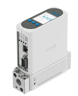

VEMD Mass Flow Controller
Lamontagne said gas control in laboratories tends to be a manual process. “This is done with manual regulators and needle valves, where a technician will come in and turn a needle valve to match the flow that's required for that day,” he explained. “This requires a lot of input from technicians, and it doesn't provide any feedback.”
In addition, it is not a scalable or reproducible process. As these laboratories want to scale in size, he said they're looking to automate a lot of processes including gas control which led Festo to develop the VEMD mass flow controller.
It provides closed-loop feedback in gas control applications, specifically for laboratory settings said Lamontagne. While mass flow controllers have existed in the market for a long time, he said what the VEMD aims to provide is an option offering both space and cost savings for laboratory automation. “We're trying to strike a balance between the cost of a mass flow controller and the accuracy that's required.”
The flow controller is comprised of:
The controller’s valve will open or close based on a set point users put into the system explained Lamontagne. For example, if the set point is 100, then the valve opening will increase until that set point is achieved.
Multiple types of gases can be controlled using the same mass flow controller; users simply need to change the gas set point in the control electronics. Flow ranges from 10-200 l/min are possible with an accuracy of ±2% of the value.
For this mass flow controller, he said Festo leaned on technology it has developed on the pneumatic side of the business. “We have a lot of closed loop pressure controllers on our pneumatic side that use the same technology,” he said. “The only difference is, rather than controlling to a flow, our more traditional controllers will control to a pressure. So, we're really leaning on and expanding our pneumatics portfolio with this mass flow controller.”
Lamontagne noted that while Festo’s industrial pneumatic mass flow controllers are designed to hit one or two set points and just stay there repeatedly, Life Science mass flow controller offers more dynamic flow control. “We have much better dynamic range depending on what the customer's [gas] chemistry is; they're able to change that day over day,” he said. “Our [VEMD] mass flow controller can hit that more reliably than industrial mass flow controllers.”

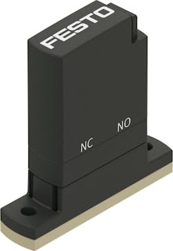

VYKA and VYKC Media Separated Valves
Festo has developed two media separated valves, the VYKA and VYKC, for the life sciences industry which were designed with liquid flow in mind said Lamontagne.
“What you see in laboratory settings is there's often limited sample size or an expensive reagent and you're worried about using enough to get the results that you want,” he explained. “But you're also worried about contamination, either from your previous sample or from the internal components of the valve.”
The VYKA and VYKC are solenoid valves with a spring and a magnetic plunger. A laboratory does not want its samples or reagent touching these internal components because they are very sensitive to leaching and contamination.
To prevent contamination issues, Festo designed its media separated valves to have a very small internal volume. In addition, the internal components are separated from the media that goes through the valve by an internal elastomer diaphragm. “By separating these components, you're no longer worried about contamination,” said Lamontagne. “And by having a small internal volume, you're able to flush out the valves much easier and have less cross contamination from one sample to the next.”
He went on to say the VYKA valve also offers the benefit of being compact in size. “For the given flow rate of this valve, we have the smallest footprint on the market,” he said. “You’re able to flow more liquid in a smaller footprint.”
Typically, as the flow rate of a valve increases so too does its footprint. The VYKA valve overcomes this though by enabling the miniaturization desired in many space-constrained laboratory settings while also providing higher throughput in the same space.
The VYKC valve is compact compared to others in the marketplace as well, though larger in size than the VYKA which enables it to be a lower-cost option for those customers where price is a determining factor.
With these media separated valves “we can really meet whatever the customer needs, whether they need a compact, high-performance valve or a similar flow rate but lower cost valve,” said Lamontagne.
Another benefit he noted is that the VYKA valve offers the life sciences sector is its tight leak rate. “Our VYKA valves are about 100 times more leak tight than a standard pneumatic valve,” he said which suits use in both gas and liquid applications and help meets the high standards required in this industry to ensure accuracy and safety.
Learn more about the importance of preventing leaks in the article "The Hidden Costs of Compressed Air Leaks."
