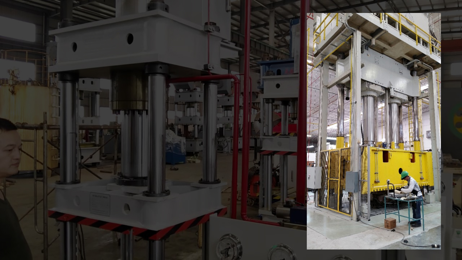

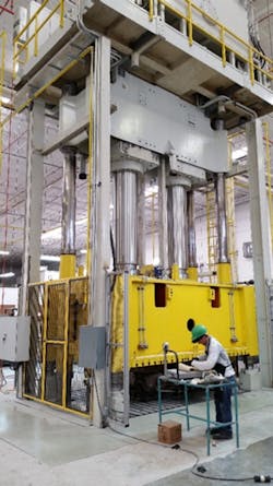

Hydraulic presses and cushions often need to synchronize four or more actuators even if the load on the actuators is uneven. Engineers can make presses mechanically rigid so uneven loads will not skew the platen or slider too much, but mechanical synchronization often fails if loads are too uneven. Today’s presses and cushions often rely on hydraulic motion controllers to avoid skew. This requires simultaneously controlling force and position.
Controlling the force requires closed-loop control that compares the desired force set point to the sum of all the actuator’ forces. The output of the force closed-loop control is the target or master velocity, which is usually slow. The master velocity must be integrated to calculate a master position all slave actuators must follow. Each actuator follows the same master position, so they remain in line with little deviation. The deviation can be limited by properly tuning the inner position loops. There will be some skew, but it is usually extremely small and within the mechanical limits.
Presses
An operating press starts by moving down using a synchronized move command. It is common to have the press come down in open loop, with the prefill valve open; the controller is not controlling this part of the cycle. The transition out of this open-loop move into synchronization is critical in getting the actuators together. In this mode, the controller generates the same target position, velocity, and acceleration for all actuators to follow. The motion controller monitors the position of the actuators to ensure synchronized motion.
Usually this part of the motion is easy to control unless there is something mechanically wrong with the press. If the press is binding or a valve or feedback not working, the motion controller quickly detects these errors and ramps down the synchronized actuators to avoid further problems.
As the platen approaches the workpiece, it should slow so that its kinetic energy roughly matches the work that must be done on the workpiece <<>>. The controller knows when contact is made because the sum of the actuators’ forces will start to rapidly increase. The scan time should not be more than one millisecond, and 500 microseconds is a lot better for detecting the moment the force starts rising as soon as possible.
Usually a few conditions must be met before the motion controller goes into cascaded-loop mode. First is to ensure the press is close to making contact. It is important the press not go into force-control mode when the platen is too high because it will accelerate down rapidly trying to reach the force set point, possibly damaging the workpiece or tooling. Second, the force must be above a certain level, ensuring good contact with the workpiece. And third, the rate of force increase must be above some threshold.
When these conditions are met the press can change to cascaded loop control. Switching between synchronized-position mode to the synchronized-position force mode should be seamless. A major advantages of computer control is that where the press starts ramping down and the speed at contact can be easily changed to accommodate different parts of various thicknesses.
