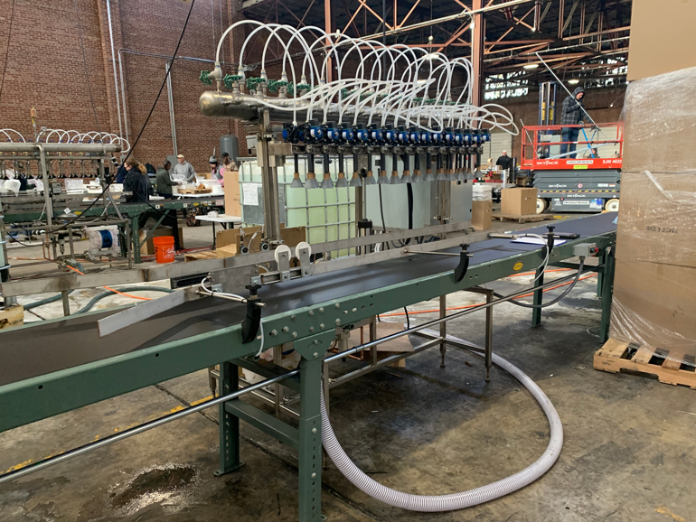

Based on these two successes, RHMC was commissioned to build to build three new filler machines. Taking what had been learned from the first two projects, assemblies were added to each machine for conveyors, box/tub handling, a supply manifold and movable filler heads.
The RHMC team had not previously created a new project specifically using industrial PLCs. Its HVAC knowledge and experience with sensors, electronic logic controllers and input/output devices was a good foundation for understanding that a PLC was needed for this new project.
The team settled on the CLICK controllers, which offered free programming software. It also reviewed many of the YouTube videos produced by AutomationDirect.
It was important to build and fabricate the machines as quickly as possible, so work was done on the plant floor. Mechanical fabrication incorporated all the lessons learned from the first two machines, and the use of all new parts and PLC automation provided much-needed flexibility. Using this approach, the third machine was quickly put into operation, built exactly to meet the client needs.
The first machine was installed in August 2020, and the subsequent four machines each went online about one per month later.
For each machine, RHMC was able to make mechanical and automation improvements while quickly responding to client requests. For example, the initial machines filled pails individually and required operators to load the pails into cases. Later machines were updated to accept cases with the pails already in them and to fill those pails while they were in the case, speeding up throughput and making handling easier for the operators. Another machine filled bulk refill wipe rolls in a bag.
Once the PLC-based machine was in operation, it was easier to revise the automation. Any improvements such as streamlined logic or better safety measures were added back into any of the other machines that had a PLC.
