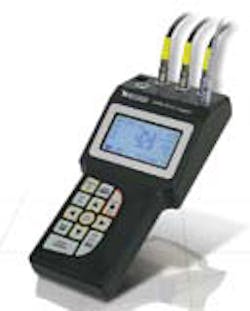

Battery-powered HPM540 handheld data-logger with USB connectivity allows easy connection of as many as four sensors and monitoring or data logging direct to laptop of any combination of flow, pressure, temperature, speed, and ...
Battery-powered HPM540 handheld data-logger with USB connectivity allows easy connection of as many as four sensors and monitoring or data logging direct to laptop of any combination of flow, pressure, temperature, speed, and analog inputs. Sampling rate of up to 0.25 msec is ideal for capturing pressure spikes. Data logging can be by time interval, on event, or on user input; automatically recognizes which SR-series sensor is connected and automatically scales input as well as engineering units.
