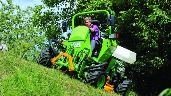

The LinsiTrak’s operator sits vertically in the seat even on a 45° slope. But the big news lies with the machine’s hydrostatic drive.

In spite of its many functions and elaborate technology, the LinsiTrak is a compact and easy-to-steer unit. Even on 45° slopes, the driver’s seat is always horizontal, thanks to an automatic tilt feature. Inclinometers continuously transmit the angle of the vehicle’s orientation to the electronic control, which then keeps the seat level using hydraulics.
