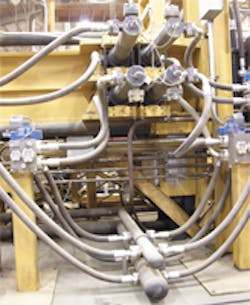

As Valley Hay’s principals began the development of a new high-capacity press, they looked for a better means of controlling the machine’s four 13-in. bore, 72-in. stroke hydraulic cylinders. The new cylinders needed to be synchronized within a tolerance of ¼ in. and operate as quickly as possible based on the agricultural material being compressed. This would require hydraulic controls that are generally more precise and versatile than those typically used in the agriculture industry.
One of the principals, Trevor Derstine, came up with an idea: He was aware that the forest products industry uses sophisticated hydraulic controls, and had a hunch that these controls might solve his own problem. It was with this intention that a local hydraulics distributor suggested they consider motion controllers made by Delta Computer Systems Inc., Vancouver, Wash.
Delta’s RMC150 programmable motion controller was selected to control the hydraulics, and Derstine asked Delta to provide technical assistance with programming the motion using RMCTools, Delta’s programming software package. Initially, Delta suggested the RMC’s standard synchronized move instructions to drive the cylinders. However, these instructions control at a certain speed and do not necessarily allow the hydraulics to go as fast as possible. This resulted in slow motion, and the presses began to show tracking errors as the compression force on the rams increased. Delta’s chief motion control technologist, Peter Nachtwey, quickly came up with a solution to the problem by developing a “synchronization quick move” algorithm.
An algorithm to the rescue
The algorithm that Nachtwey developed for the hay press is, in essence, an open-loop command applied selectively to different valves, which enables the hydraulics to move the rams at maximum speed. The algorithm always gives full control voltage to the axis that is the furthest behind, and regulates the control voltage to the other axes so that all axes remain synchronized. In contrast, a standard closed-loop command cannot move at maximum velocity, and yet retain control.
Delta then implemented the algorithm within an RMCTools user program. User programs are similar to macros in conventional computer languages, but with a graphical interface. Delta’s user programs make it easy to create motion sequences and are powerful enough to implement advanced, high-speed control algorithms. This feature allowed Delta to quickly implement the algorithm, whereas implementing the algorithm as a standard instruction in the controller’s firmware would have required more resources and time. In the future, Delta Computer Systems plans to add this algorithm to the RMC’s command set so other machine builders can easily access this feature.
After implementing the algorithm, Delta’s engineer tested the algorithm using the RMC’s built-in simulator while working at his office desk. Because the algorithm was pre-tested and used existing tuning gains, the algorithm worked flawlessly the first time it was operated on the real system hardware. The algorithm achieved a synchronization tolerance of less than 0.005 in., much less than the required 0.25 in.

The new synchronized multi-axis move algorithm worked so well that the Valley Hay machine designers decided to apply the algorithm to four other hydraulic cylinders, which eject the bale after the compression is completed, and to the retract stroke on the main press cylinders. To control these additional axes, Valley Hay added a second RMC150 motion controller to the machine. The single-axis pre-compressor actuator that pushes the bale into position in the press also implements closed-loop motion. A PLC provides basic supervisory control, simply instructing the Delta RMCs to start their programs.
The operating results were immediate and impressive. The compression cycle time had taken more than 300 sec to complete. With the new controllers, the cycle takes about 53 sec with rye grass. At this rate, a whole shipping container can be loaded in just 45 min — far less than the previous average of 2 hr. “This gives us a real economic advantage over our competitors,” says Derstine. “We’re also saving costs on production. Fewer people are needed to operate the machine, and we have less material waste. Plus, we package the bales in sleeves instead of traditional strapping and shrink wrap — and this saves money.”
