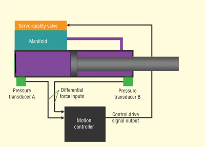

Pressure transducers are commonly applied in pairs for force control applications. Separate sensors are used to monitor the pressure on each side of the piston (see Figure 1). This allows one to calculate the difference in force by using the formula:
Force = PPE APE – POE AOE
Where:
PPE is pressure on the powered end of the piston,
APE is the area of the powered end of the piston,
POE is pressure on opposing end of the piston, and
AOE is the area of the opposing end of the piston.
This calculation provides the true net force except for seal friction.

Figure 1. Precise pressure or force control can be performed using an electronic motion controller and pressure transducers mounted on both sides of the piston.
Location, location, location — The locations where pressure transducers are mounted in a system are critical factors for satisfactory operation. It is best to mount the pressure transducers as close as possible to the points of interest on the cylinder, as shown in Figure 1. Here’s why:
