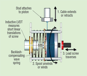

Simplified drawing explains operation of SL720 position sensor and shows major components. Hybrid hydraulic drives use accumulators to store kinetic energy from braking as hydraulic energy instead of braking a vehicle ...

However, an important drawback of LVDTs is their relatively short measurement range. It’s not practical to directly measure a long linear translation with an LVDT. A solution to this problem is to use a coupling mechanism suitable for use in a hydraulic environment that extends the range of the LVDT. A sensor that embodies this approach is the SL720 linear position sensor, from Control Products Inc., East Hanover, N. J.
A long-stroke LVDT
The SL720 uses a fine lead screw to couple an LVDT to a recoil spool. The recoil spool has a cable that is capable of extending up to 6 ft (1.8 m). When the spool rotates, it causes the screw thread to turn and produce a small linear translation that is read by the LVDT. In this way, the LVDT is coupled to the long translations of an object such as a piston in an accumulator, producing accurate absolute measurement of piston motion and position.
The SL720 can be used in either the gas side or the oil side of an accumulator. This key point fulfills the requirement for minimal design impact. The SL720 also has a high-pressure electronics connector with integral signal conditioning that solves the problem of conducting electrical signals into and out of the pressure environment. The recoil spool approach provides some other advantages. For example, the sensor’s range does not need to be matched to the specific travel requirement of a particular application. The SL720 covers any stroke up to 72 in. and the cable coupling tolerates some misalignment. This presents some new opportunities, such as integrating a linear sensor with a bladder-type accumulator or a telescoping cylinder.
