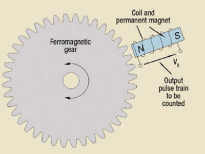

Figure 1. The magnetic pickup is a simple device that is normally used as a speed sensing device, but it is actually an encoder.
• rotating ferromagnetic protrusion with magnetic pickup,
• dc brush-type tachometer and
• brushless dc tachometer.
The ferromagnetic protrusions can be gear teeth, a shaft key, a key way (an inverse protrusion), or any other ferromagnetic irregularity of the rotating member.
The rotating ferromagnetic protrusion type is widely used because of its simplicity, Figure 1, so this will be our focus. We will address tachometers in a later issue. In the laboratory, it is common to mount a 60-tooth iron gear onto a shaft, then mount a magnetic pickup near the teeth. The frequency of the generated voltage from the pickup is directly proportional to the speed of the shaft, in rpm. All that is needed is an electronic digital counter, which counts the number of pulses that pass during a precisely controlled gate time. If the gate time is set to 1 sec, and the gear has 60 teeth, the frequency, in Hertz, is exactly equal to the speed in rpm.
The gate time does not need to be exactly one second, and the number of teeth or protrusions does not need to be 60, because any combination simply requires a different scale factor to convert frequency to rpm. If there is an onboard processor, scaling is easily accomplished with software.
