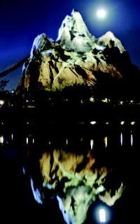

Guests also catch frequent glimpses of Everest towering in the distance. The structure is nearly 200 ft tall, but appears much taller through forced perspective. Forced perspective involves altering the scale at which objects are constructed and painting shadows that create a false sense of depth.

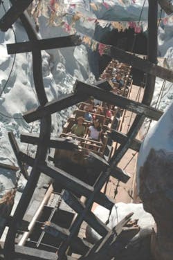

As they approach a loading platform, guests see and hear coaster trains approaching and departing. A train departs as often as once a minute with as many as 34 passengers on each. The coasters are adorned with features that make them appear to be old rusty trains. They have a steel framework with outer bodies made of fiberglass for a combination that is light weight, strong, and durable.
To add realism to the scene, steam is routed to nozzles mounted under the loading platform. This makes it easy to see and hear the steam, but keeps it a safe distance from guests and attraction personnel. A blast of steam is released every time a train stops at the loading platform, giving the impression that the train is, indeed, powered by a locomotive. Steam is again released — and a steam whistle sounds — once the train has been loaded and begins its departure.
It's a switch
Upon departure, the train ascends the attraction's first hill. After climbing a second hill, 112-ft high, the coaster enters a snowy canyon. Something appears seriously wrong. Huge footprints in the "snow" and a distant roar signal that the guests have infringed on the yeti's space. Worse yet, the track ahead is broken and twisted — with nowhere to go except off the track and over a steep cliff!
Lacking any other recourse, the train comes to a halt, then backs up. But instead of heading back into the loading area, it crosses over a switch track that diverts it — backwards — to an alternate route. The coaster continues backward and up through a spiral and eventually stops at the top of an incline. After a brief pause, it rolls forward down the hill, then crosses over another switch track that sends it down an 80-ft drop. The coaster reaches speeds up to 50 mph.

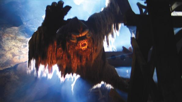

John Van Oort, Principal Mechanical Engineer, Show Mechanical Group, Walt Disney Imagineering, Glendale, Calif., explained that the power and precise motion of the application clearly called for hydraulics. He revealed that the total thrust from all 19 motion axes generates nearly 260,000 lb of force.
Rather than try to support the yeti by its own legs, the figure is supported through a steel boom attached at the rear of the figure — roughly at the small of its back.
The figure is securely attached to the end of the boom and becomes a load suspended from a cantilevered beam. The boom also provides two major axes of motion: about 2 ft of vertical motion of the torso, and 5 ft of forward-backward thrust. The boom also supports the hoses and control cables going to the yeti.
More than meets the eye
Hydraulic and electrical power, plus electronic control and feedback signals are routed through a boom, which is visible under the yeti's left arm. This boom, secured to the small of the yeti's back, also provides two major axes of motion.
This setup allows the yeti figure to appear to have even more than 19 axes of motion. Van Oort said both feet and the left hand all are attached to structural framework inside the attraction. Legs are free to bend at the hips, knees, and ankles, and the left arm is free to move at the shoulder, elbow, and wrist. None of these joints are considered motion axes, because they are not powered.
Van Oort revealed, "There are no actuators in his legs or left arm; they just go along for the ride." The thrust and vertical motions of the boom are powered by hydraulic cylinders. The structure consists of stationary framework and a sled, which is pushed forward and backward on ways (plane bearings) by hydraulics.
Van Oort explained, "We reverted back to pre-World War II technology in that the sled runs on sliding ways, like in old machine tools. We have a huge cantilevered load, and the only way to the get the PV [combined pressure and velocity] of the bearings down was to put the sled on ways."
Mounted to the sled is a second hydraulic cylinder that pushes and pulls a second sled up and down. The beam that supports the yeti figure is rigidly attached to the framework of the sled that moves vertically. Therefore, this entire assembly generates two axes of motion.
