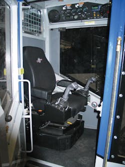

The spacious cabin of the TF 830 includes electronic joysticks to control forwarder functions such as the telescopic boom, steering, rotation, and grappling. Click on image for larger view.
Operation of the machines is fairly straightforward — the operator uses electronic joysticks, handles with control buttons, switches, and an electronic foot control to send signals to an onboard IQAN system, developed by Parker Hannifin Corp., Cleveland. IQAN is an electrohydraulic management system that monitors operator inputs and converts these data to a usable electronic signal to control hydraulic valve and hydrostatic drive functions.
IQAN also communicates with other systems, including the machine's 300-hp Cummins diesel engine and multiple temperature and speed sensors. A Master Display Module (MDM) is connected to other control modules using CAN communication. The MDM displays data from these systems and also allows control of them. After receiving input from sensors and control input from the operator, IQAN sends out control signals to the proportional coils located on a Rexroth wheel-drive pump and Parker/VOAC control valves.
