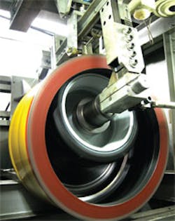

Figure 1. The Innkeeper system controls the wheel’s position in two axes as it spins inside a rotating drum.
For example, Innkeeper LLC, Redford, Mich. developed a system for testing automotive wheels by applying forces in two axes simultaneously, or biaxially, using servohydraulic cylinders, Figure 1. This method provides a significant improvement over traditional single axis wheel testing methods and is used to discover which wheel designs will survive without failure once attached to a vehicle. In this system, one hydraulic cylinder applies a radial (vertical) load to the wheel as it spins at freeway speeds inside a moving drum. A second cylinder simultaneously applies a lateral (cornering) load to the wheel.
Other wheel test machines apply force to only one axis at a time, but based on 40 years of combined experience, Innkeeper’s engineers believe that only by testing wheels with cornering stress and vertical stress simultaneously can a truly realistic durability test be performed.
By recreating the most stressful driving conditions on the wheel under test, the machine is able to accelerate the wear and tear seen in a lifetime of road use. Innkeeper’s test system can impart structural stress equivalent to 150,000 mi of road use in 3½ days. Obviously, this accelerated testing saves the vehicle and wheel manufacturers a significant amount of time and money compared to on-road or track testing.

The challenge for controlling the servohydraulic cylinders within the test system is that there is always interaction, or cross coupling, between the two axes while in force control. Applying a lateral force through the machine imparts both a lateral and radial force component into the wheel. These forces change due to the angular relationship between the wheel axis and the machine axis, Figure 2. The angular relationship between these two axes changes constantly and, as a result, commanding and holding a steady force is like shooting and hitting a zigzagging target.
