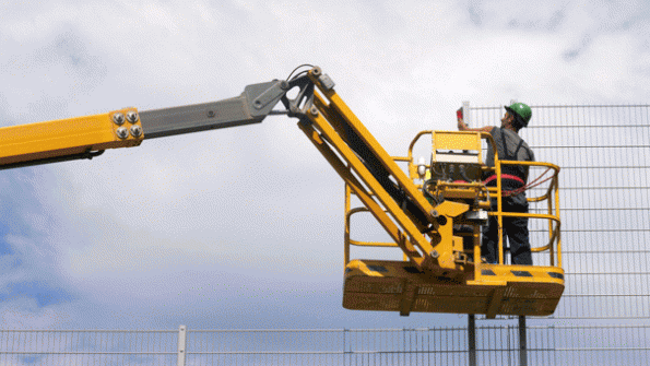

Keeping the work platform of aerial lifts level is a primary safety concern, and LPI inclinometers closely monitor horizontal orientation in one or two axes to close the loop in electrohydraulic positioning controls.
Most forklift trucks used in warehouses pose no great challenge to keep loads level because floors are level. Generally, an operator keeps loads level simply by actuating a hydraulic valve to control cylinders that tilt the vehicle's forks backward. Such is not the case with all-terrain forklifts, where uneven and unstable ground are expected. Keeping loads level on aerial work platforms is even more critical because the load usually consists of people.
Level sensors (inclinometers) were developed to provide feedback to a machine control to keep loads level. Today’s closed-loop electrohydraulic systems can provide automatic leveling. To accomplish this, the inclinometer sends an analog-based signal to the machine’s control, which then commands a proportional hydraulic valve to shift one way or the other to keep the load level.
