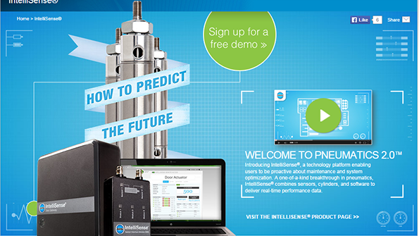

The intelligence of IntelliSense is embedded inside a Sensor Interface Module (SIM), a remote monitoring device connected to sensors attached to Bimba cylinders using pneumatic fittings. Users receive operational insights about cylinder condition, cycle time, pressure (to 0.01 psi), and temperatures (down to 0.01°).
In addition, IntelliSense delivers predictive intelligence for pneumatics in the form of up-to-date condition information that predicts when a cylinder will fail. IntelliSense can also identify when a component is achieving its desired performance specification. For example, users will be alerted if a cylinder that should be actuating in 1 second is taking 1.5 seconds. This is especially important in sequencing applications that depend on precise stroke rates. Ultimately, this machine-to-machine technology lets users  move from emergency repair to proactive maintenance, thus optimizing production as a whole.
