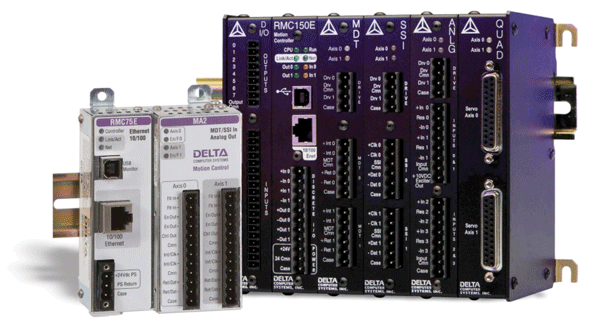

To remove these limitations, new capabilities are being added to motion controllers that add flexibility in the number and type of feedback devices that can be used, with the ability to perform pre-processing of feedback data before it is used by the control loop. These advances bring new dimensions of precision and reliability to motion systems, and can be grouped under the general term “custom feedback” (Fig. 1).
Fig. 1. The Delta RMC75 two-axis motion controller (left) and RMC150 eight-axis controller support user-programmed custom feedback options described throughout this article.

Two motion controllers with custom feedback processing capability are the RMC75 two-axis controller and RMC150 eight-axis controller manufactured by Delta Computer Systems Inc. (Fig. 1, again). When programming these controllers, axes defined with custom feedback do not have an assigned physical feedback (i.e., direct connection to I/O). Rather, they use the contents of internal registers as feedback variables. The machine designer creates a user program that continuously calculates the feedback value and assigns it to the appropriate register, whose contents are in turn used by the motion controller’s control loop. The ability to employ user programs gives users the flexibility to perform any logic functions and calculations necessary for precise closed-loop control.
User programs carry out complex sequences of commands on the Delta RMC controller without requiring intervention from a PLC or other controller. This allows the controller to respond to events within its control-loop time, which can be as short as one millisecond, rather than the scan rate of a PLC, which can be more than ten times longer, imparting latency delays and limiting the speed of the process that can be controlled. Incorporating the feedback processing function into the motion controller also reduces the amount of PLC programming required. The number of user programs supported by Delta’s controllers is only limited by the memory capacity of the controller.
