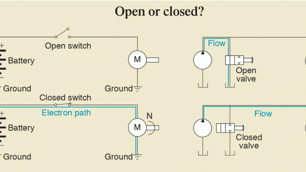

Figure 1 — At left, electrons flow when the switch is closed, whereas hydraulic fluid flows when the valve is open, right. Even though the switch is connected in series, and the valve is connected in parallel, functionally, these are equivalent circuits.

Consider the simple electrical circuit diagram on the left side of Figure 1, which shows a battery, switch, motor, and connecting wiring that ties the components together and to ground. The purpose of this circuit is to be able to turn a motor on and off. The hydraulic complement of the simple motor circuit is shown on the right side of Figure 1.
The battery symbol is a series of alternately long and short parallel lines. The longer line denotes the positive terminal of the battery, and the shorter, the negative. The battery symbol gives no clue as to construction. It could be the lead-acid type used in cars, an alkaline type found in flashlights, or a lithium-ion type for a laptop computer. Likewise, the pump symbol used in hydraulics does not designate the type of construction — it could be  a gear pump, vane pump, or piston pump.
Open or closed?
The switch symbol is generic, but it implies a moveable blade that engages two leaves that pinch the blade to make electrical contact. When the contact is made, we say the switch is closed, and here is one of the sources of confusion when coming from a world of hydraulics to the world of electronics. Closing a switch is analogous to opening a valve.
One of the most fundamental laws of electricity is that electrical current must always close on itself, thus, the current describes and follows a complete closed path. In our simple circuit, this means that for every electron leaving the negative terminal of the battery, one electron must enter the positive terminal. A complete loop must exist in order for current to flow.
Some of the imperfections in the analogies occur because the electrical circuit uses a constant voltage source (battery), whereas the hydraulic circuit uses a constant-flow source (positive displacement pump). When the hydraulic bypass valve is open (flowing), there will be a small pressure felt by the motor, and the motor shaft may even rotate if there is no load on it.
In the upper left circuit in Figure 1, the loop is open, so there can be no current. In the lower circuit, the loop is complete, so there is current; the motor is powered, so it turns. So when we “close the switch,” we really mean we close the circuit.
