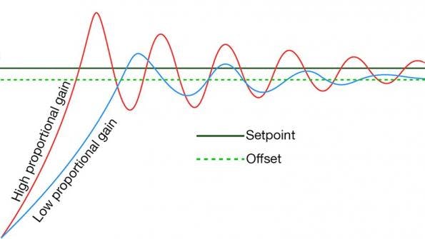

A typical position-control hydraulic servo consists of a control valve (either a servovalve or a high-response proportional valve), hydraulic cylinder with a position-feedback transducer, and an electronic controller to close the control loop. Loop gain is the product of all component gains in the loop when the feedback path is open. The dynamics in the loop act on the open-loop gain as the input signal frequency increases. These dynamics cause the loop gain to change with signal frequency, and they introduce phase lags into the loop.
The allowable loop gain is the maximum loop gain that produces a control-loop dynamic behavior to meet specified stability criteria so that a stable output response results when the loop is closed. Because loop gain is sensitive to signal frequency, it typically is specified as the loop gain at a reference frequency of 1.0 rad/sec. The allowable loop gain will determine the servo’s static and dynamic position-control accuracy. Therefore, the allowable loop gain should be as high as possible.

The allowable loop gain for position-control hydraulic servos can vary widely, depending upon the specific application requirements. However, our experience indicates that a typical allowable loop-gain range for mobile hydraulics is 7 to 15 sec-1and 15 to 30 sec-1 for general industrial applications.
Note that allowable loop gains from the two equations are proportional gains. There will be some applications where proportional gain only is not high enough to meet the control-accuracy requirements. In these cases, some means of electronic gain compensation can be included in the electronic controller. Allowable loop gain increases by factors from 3 to 10 are not uncommon. When such a situation occurs, the electronic controller supplier should be consulted to provide the necessary gain compensation capability.
