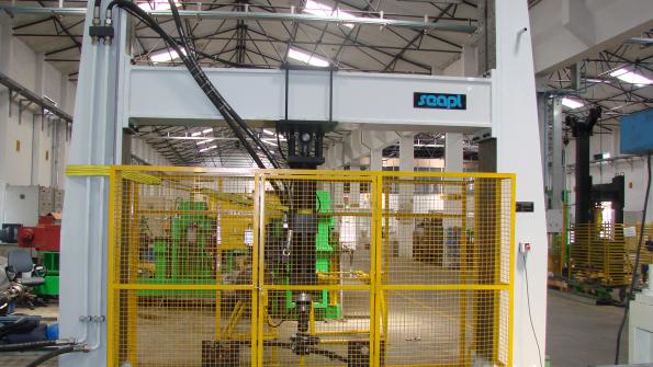

To complete the spring test system, the RMC75E controller was paired with the following system components: To apply the force on the leaf spring under test, SEAPL manufactured a 1-tonne servohydraulic cylinder with ±100 mm stroke. To control the cylinder, it was important to use a proportional servovalve so that different amounts of fluid can be metered out to the cylinder, allowing for very precise force to be applied to the specimen.  For this task, SEAPL selected a 170 lpm unit manufactured by Atos SpA.  To measure the displacement of the specimen, the company chose a 200mm LVDT from Gefran SpA. To measure force, the system uses a model 15T load cell from ADI Artech.  The completed test system is shown in Figure 2.
2. The SEAPL spring test apparatus
