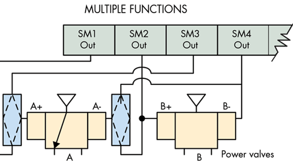

Multiple outputs—When two (or more) functions start with the same step, connect the output from that sequence step to both power valves.
Multiple functions—Functions that actuate twice during the sequence call for the system to connect a shuttle valve (OR function) to the pilot of the power valve.
