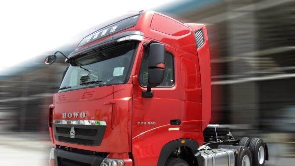

1 Major Chinese commercialvehicle manufacturers have adopted WABCOrsquos electronically controlled airsuspension technology OptiRide on their advancedvehicle platforms including CNHTCrsquos heavyduty truck HOWO

Major Chinese commercial-vehicle manufacturers have adopted WABCO’s electronically controlled air-suspension technology, OptiRide on their advanced-vehicle platforms, including CNHTC’s heavy-duty truck HOWO.
