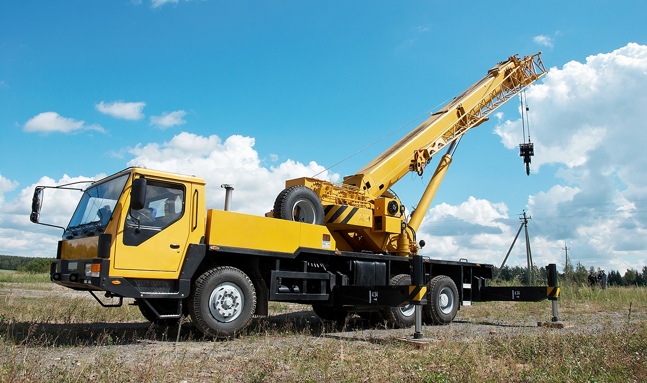

Crane outriggers are just one application that can benefit from magnetostrictive linear transducers (below) designed for use in hydraulic cylinders on mobile equipment.
