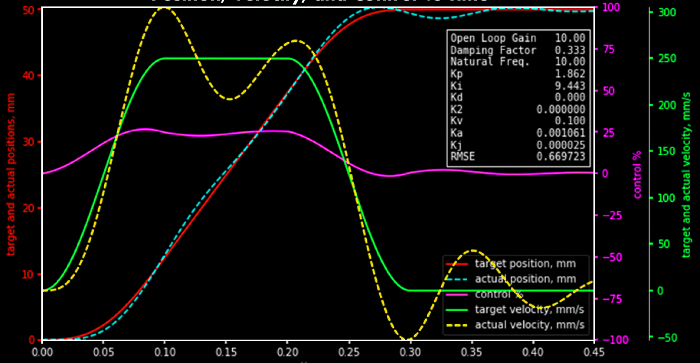

A hydraulic cylinder can be simply modeled as a mass between two springs. Systems with a low natural frequency (the frequency at which the system oscillates after a sudden start or stop) have a low spring constant relative to the mass of the load. Conversely, systems exhibiting a high natural frequency have a high spring constant relative to the load mass. So how high should the natural frequency of the cylinder be relative to the frequency of acceleration? Ideally, the natural frequency should be at least four times the required frequency of acceleration —the frequency at which the cylinder’s piston and load accelerate. This is true when using a standard hydraulic motion controller.
1. In this plot, the frequency of acceleration is 5 Hz and the natural frequency of the system is 10 Hz. The actual position and velocity values do not accurately follow the target values; note the Root Mean Squared Error (RMSE). The motion will be “jerky.”

A simple example illustrating frequency of acceleration is a cylinder and load following a sinusoidal motion at 5 Hz. In this case, the frequency of acceleration is 5 Hz. If the cylinder is just making a simple move from one position to another, the frequency acceleration is 0.5 seconds divided by the minimum of the acceleration or deceleration time. This assumes the acceleration and deceleration ramps are sinusoidal S-curves having one fundamental frequency with no harmonics. (Linear ramps have the fundamental frequency and many harmonics that may cause problems.)

Here’s a graphical example: In Fig. 1, the frequency of acceleration is 5 Hz, and the natural frequency is 10 Hz. The natural frequency is only two times the frequency of acceleration, so the following error is large. (Note the root mean squared error value, RMSE.) Figure 2 shows that increasing the natural frequency to 20 Hz reduces the error between the target and actual position.
