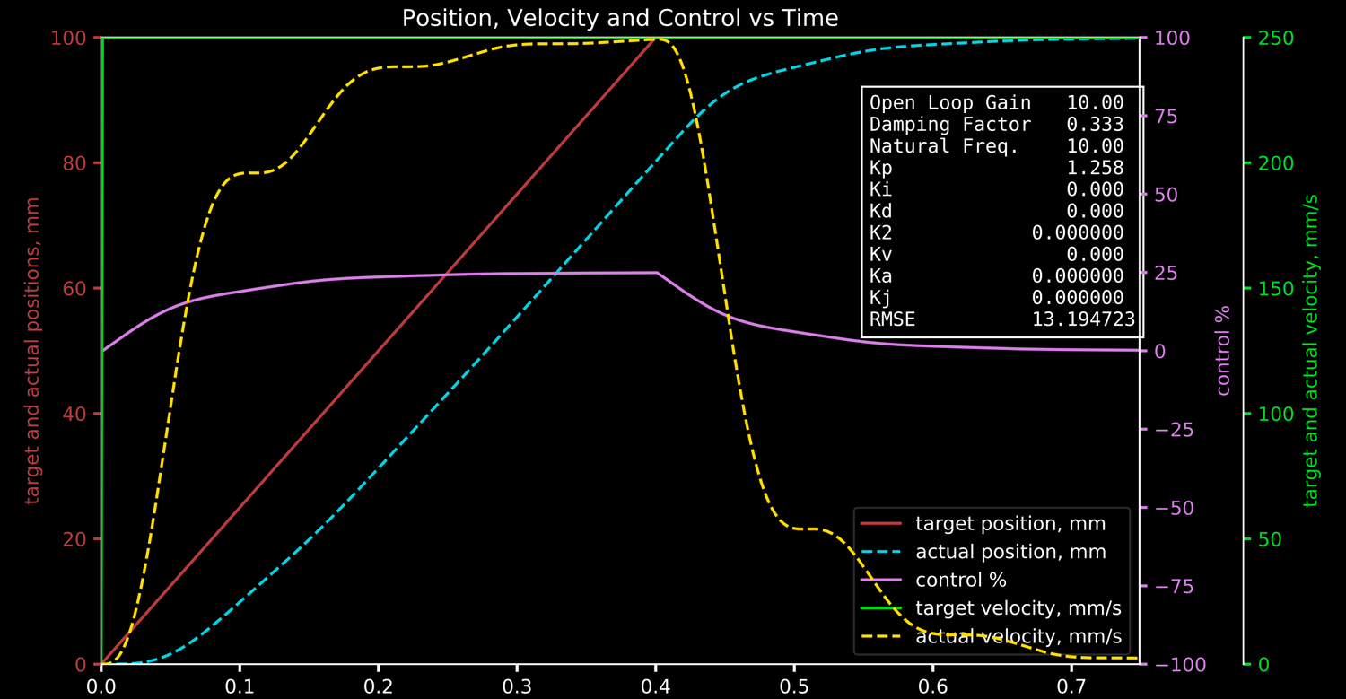

The response of a proportional-only controller is relatively slow, and efforts to increase the response usually result in oscillatory motion. The time constant for the error to decay is too long, and the bandwidth is not high enough to come close to tracking even modest acceleration rates. The best response is determined by the natural frequency and damping factor, both of which are out of the hands of the PLC programmer. The natural frequency of the cylinder and load must be increased significantly to achieve a reasonably acceptable response.
Figures 1 and 2 show the response with the natural frequency increased from 10 Hz to 20 Hz. The improvement is not that great, but doubling the natural frequency means the diameter of the cylinder must be approximately doubled. However, this increases the oil flow requirement by a factor of four. Doubling the natural frequency is cost-prohibitive.
1. Simple proportional-only motion with a natural frequency of 10 Hz for the system.
2. Simple proportional-only motion with a natural frequency of 20 Hz for the system.
Notice that there are no acceleration and deceleration ramps. It is possible to increase the proportional gain higher than the optimal proportional gain. Doubling the proportional gain will reduce the following error, but it will not reduce the settling time. Increasing the proportional gain too much will result in overshoot or possibly continuous oscillations, which could damage the machine.
