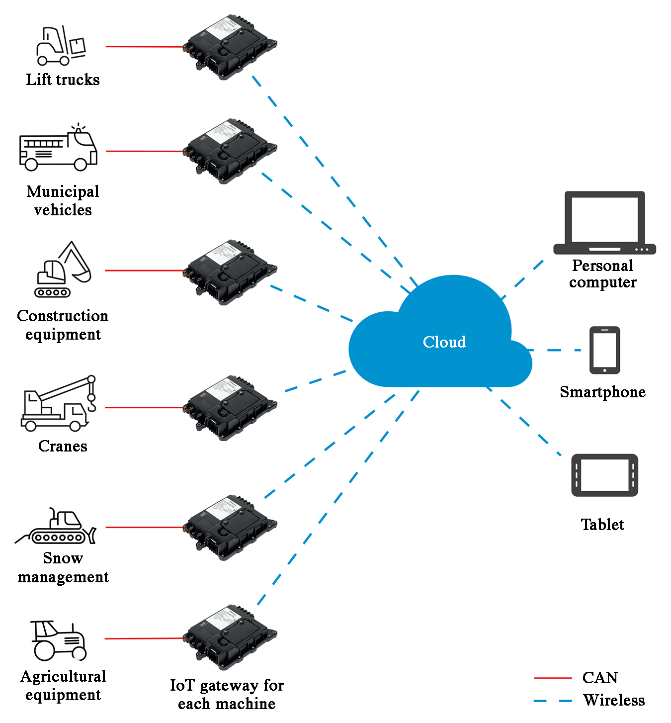

Telematics involves monitoring equipment remotely by analyzing data gathered on a machine’s CAN, transmitting data wirelessly via an IoT gateway to the Cloud and interacting through a smart device.
TTControl has developed a comprehensive IoT platform that includes a Cloud solution and a gateway to address the needs of OEMs and fleet owners. The TTConnect Cloud Service can be integrated seamlessly into existing electronic architectures of machinery, enabling remote access to data available in a vehicle’s CAN networks. This includes traditional engine data—such as engine speed, load variations, or fuel consumption—but also additional diagnostic information gathered from ECUs, hydraulic systems, and sensors.
To achieve this, TTConnect Wave, a ruggedized IoT gateway suitable for harsh environments typical for off-highway vehicles, is installed on the machinery and connected to the CAN networks. The gateway collects data and redirects them to the Cloud, a web portal accessible anywhere, anytime, from any web-enabled device that lets users observe and analyze all collected data.

The platform stores a database of the CAN data the user wants to monitor. The configuration is transmitted to the IoT gateway device installed on the machine, so only the selected parameters will be monitored. The Cloud offers intuitive dashboards and widgets that can be customized, allowing for a fast understanding of any live parameters of the vehicle. User accounts with custom dedicated access rights can be created through the web portal to tailor data to the requirements of certain end-user groups—for example, configuration engineers, service technicians, or operators monitoring alarms.
The IoT gateway acts independently from the machine’s ECUs , so it can be retrofitted easily. It reads data via multiple CAN networks and transmits it via its cellular interface when it is connected to a mobile network. When the machine is not connected, it stores the data until the vehicle re-enters an area with network coverage. The set of CAN data to read and transmit to the platform is defined by the CAN data database previously defined in the Cloud configuration section.
