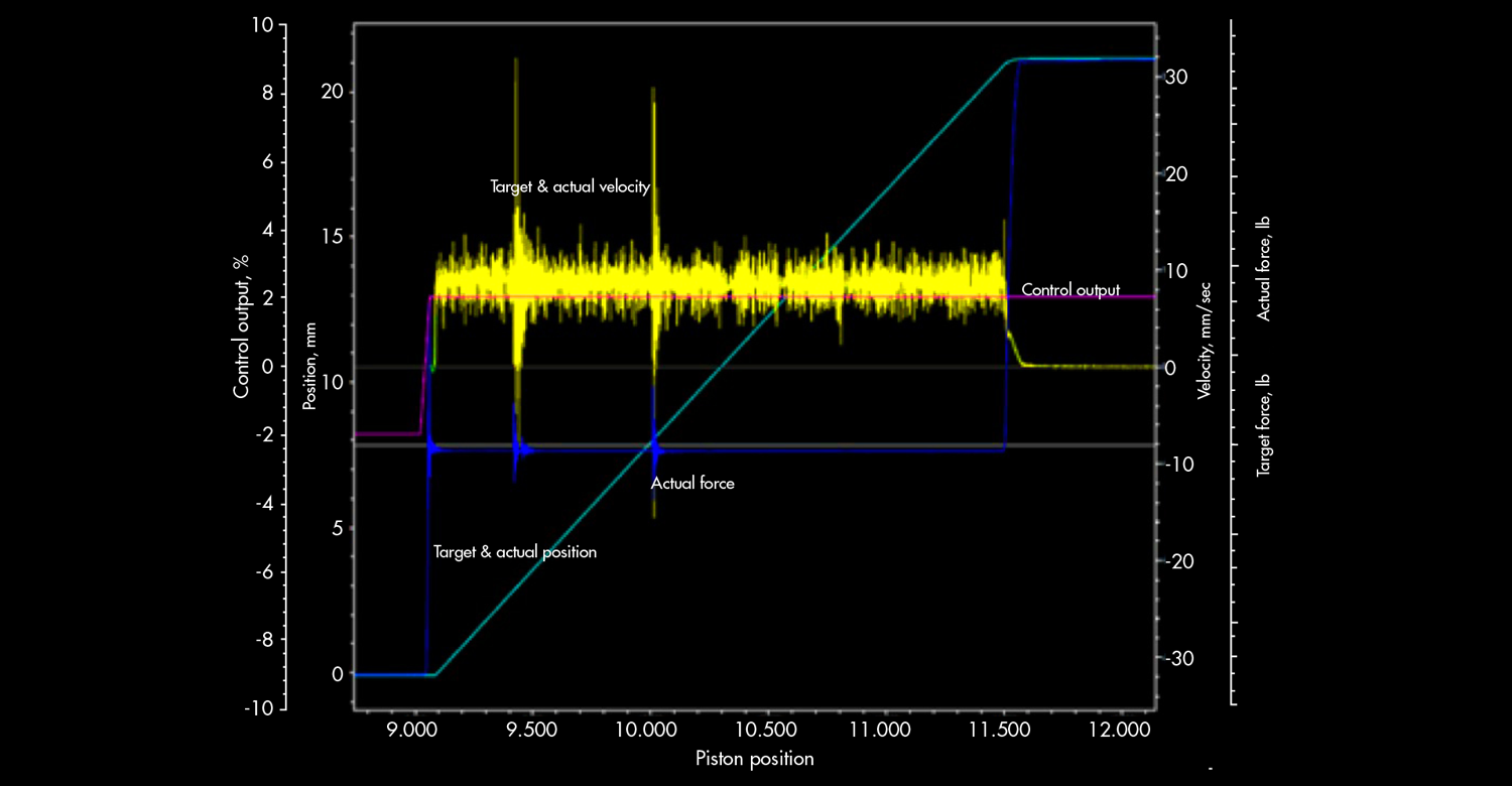

Other things I observe at when moving slowly back and forth in open loop is checking for smooth actual velocities. Sometimes there are rough spots in the cylinder or mechanical linkages that cause the velocity to change at certain positions. It is easy to see this on a graph of the actual position and velocity (Fig. 4).

The plots make it easy to identify rough spots or binding in the system during the cylinder stroke. Sometimes the system is trying to move a heavy load hampered by high static friction. Ideally, the friction should increase linearly with velocity. However, in the real world, static friction can be very high relative to dynamic friction. This results in what is referred to as stick-slip motion (or stiction), where two touching surfaces alternate between moving smoothly and stalling. This causes the motion to be jerky when moving slowly. Inside the cylinder, the pressure and force build up until the force is enough to overcome the static friction. The piston and load move, but the pressure and force fall rapidly as the oil expands. Eventually, the force is not enough to move the piston and load fast enough, so the piston and load stick again. This sticking and slipping happens fairly quickly. I have seen cases where the jerky motion has made the system unusable.

4. Cylinder rough spots can be seen just after 9.4 sec. at 3 in. and 10 sec at about 8.2 in.
