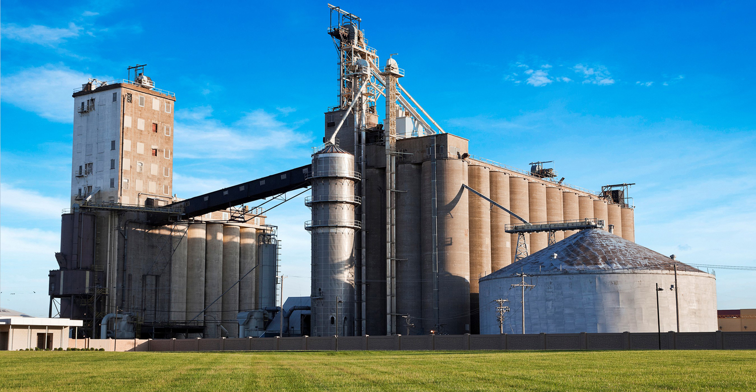

A typical agricultural bulk processing plant may contain 30 to 50 hoppers or silos throughout the facility, each with a gate that opens and closes to dispense product for the next step. In this particular application, the seed went to one process for coating, then it was stored elsewhere before going to the final hold area, onto a conveyor, and, finally, into the bagging system.
