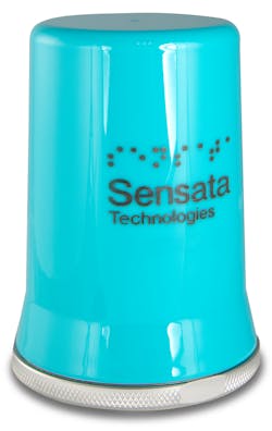

The wireless 6VW sensor easily mounts to a variety of rotating assets to help determine when and if faults may occur.

Sensata Technologies has introduced the new wireless 6VW series IoT (Internet of Things) sensor designed to aid predictive maintenance of rotary assets. The sensor delivers information to the recently launched Sensata IQ platform—a cloud-based platform which uses artificial intelligence (AI) to process data from Sensata IoT devices.

The 6VW is a wireless sensor capable of operating on cellular, LTE or Wi-Fi. It is a multimodal sensor which allows collection of various data points beyond vibration due to sensor fusion onboard of several sensors, says Siafakas. The sensor is able to collect temperature, vibration and acoustics information to provide customers with a more accurate picture of the health of their machine.
Collecting acoustic information is important, says Siafakas, “because it allows you to detect some higher frequency faults such as lubrication faults which a typical vibration sensor is not able to detect.”
Essentially, a wider range of faults can be detected, and more alerts sent to the maintenance team so they can plan accordingly. The 6VW sensor can also do electrical detection, expanding upon the types of faults to which it can alert personnel.
Siafakas says the sensor is easy to install; it mounts via a magnet and can be configured within 5 min. using Sensata’s mobile app. He explains that users answer a few questions during the configuration process based on information found on the motor to which the sensor is mounted.
